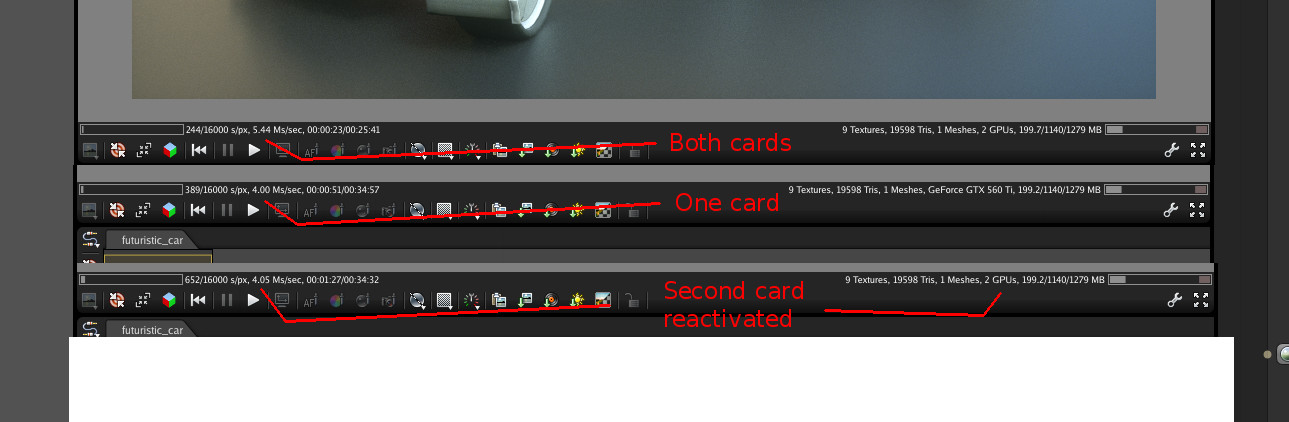

mib2berlin wrote:Hi, thanks for the new RC but..
I cant deactivate and activate a GPU in Preferences without stuck with the performance of one card.
For example:
Deactivate GTX 550Ti for faster viewport, render only on GTX 560Ti.
Reactivate the GTX 550Ti but get only the performance from the GTX 560Ti.
I have to reload the scene to get the performance of the two cards back.
Is this regular or is it a bug?
It would be nice if somebody from Otoy team can answer this question.
Cheers, mib.
EDIT: This work with 1.11
Hmm, it sounds like a bug, but I couldn't reproduce this issue. What exactly are you doing? Does one of the GPUs fail?

mib2berlin
Posts: 1194
Joined: Wed Jan 27, 2010 7:18 pm
Location: Germany
Yes, both GPU are showing in the render window but only one is working if you enable it again.
No error messages.
Maybe it is linux related?
Cheers, mib.

mib2berlin
Posts: 1194
Location: Germany
Hi, thanks for testing.
It always happen on every scene.
I don´t have a GPU meter but if I loot to the themperatures only one card ascends, second reactivated card stand still on 65 C°.
Cheers, mib.
EDIT: It only happen if i pause render before switch second card on or off.
If I switch during rendering it works.
But was different in 1.11.

abstrax
Posts: 5510
mib2berlin wrote:Hi, thanks for testing.
Cheers, mib.
Cool thanks, pausing was the key. I can reproduce it here and try to fix it. Thanks.
