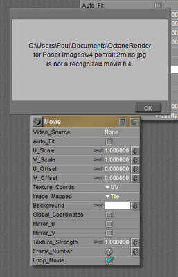

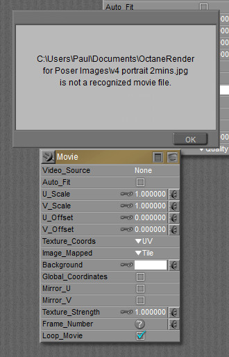

This error is generated if I try to load a jpg or png into a movie "Video_Source".

look here ;)
you have found a error because the file is not numerated !! incredible smithmicro :lol:
face_off
Posts: 15774
Location: Adelaide, Australia
Wow - there is an undocumented feature if I have ever seen one!
I can load a single jpg if it's numbered, but subsequent images in the numbering sequence don't seem to load or render (and querying the movie name in python gives to texturemap name that you originally selected - not the one for the current frame). But maybe there is another trick to it...

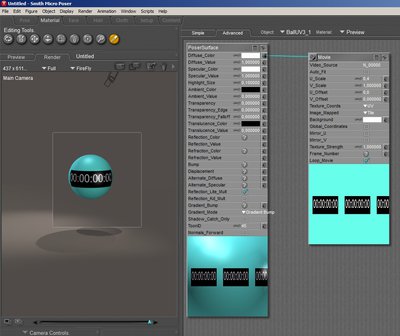

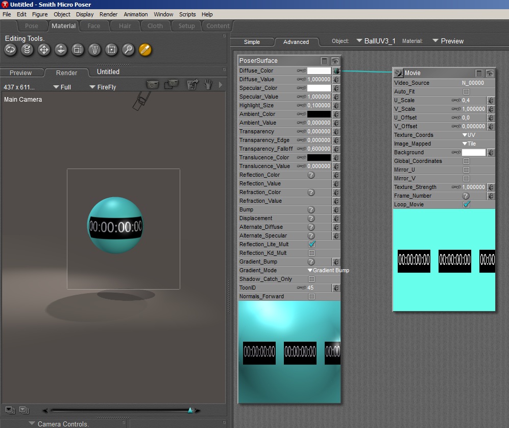

another problem in poser is the preview about 2d texture "sequence" movie .. all black :roll:
