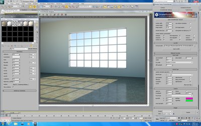

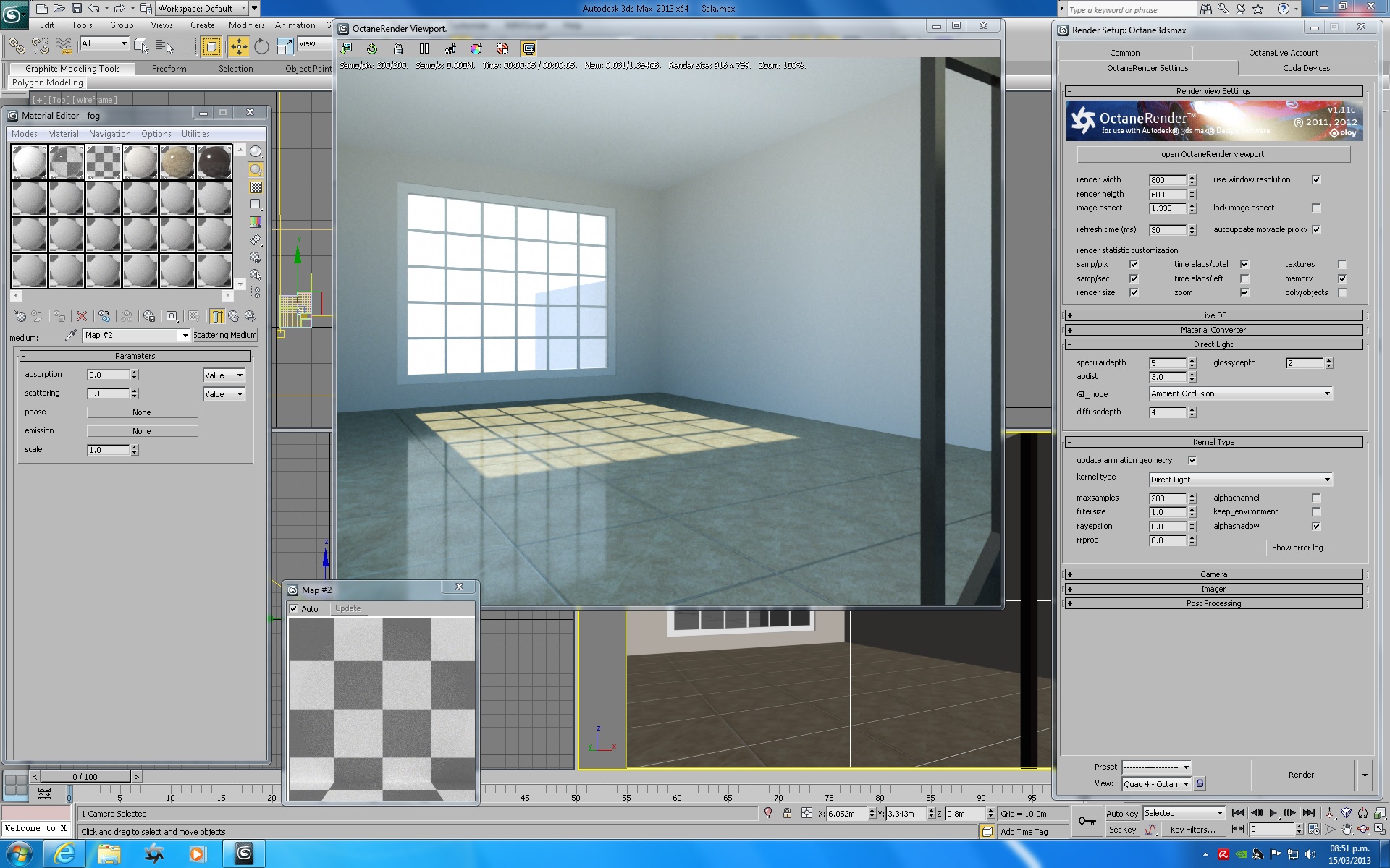

am trying to do an single exercise with fog color and nothing happen, i follow the setting of material profbetis and the image just is the same, nothing happen
add image
is the same with directlight, pathtracing or pmc

Are you sure? Try adjusting your ao_dist parameter or switch to diffuse mode. I think it's just very evenly lit. Also try putting a daylight light in there

hi profbetis, i can't creat fog like your parameters, add image and file if you can help me

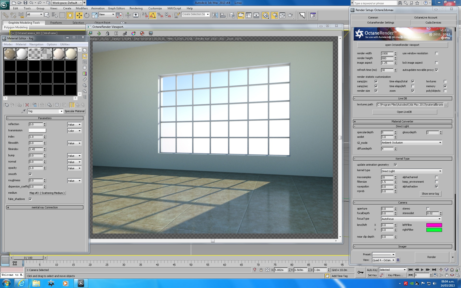

I posted my scene on the last page if you want to download that.
Make sure your camera is outside the volume and that Fake Shadows is on in the specular material. Also mess with the scale property in the scattering medium.
One question for Karba: In my scene, if I turn off fake_shadows, I don't get direct sunlight in there? somehow it gets the sky but not the sun? Shouldn't a more realistic calculation include the sun as well? What's different about the sun than different light sources like the sky?
