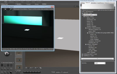

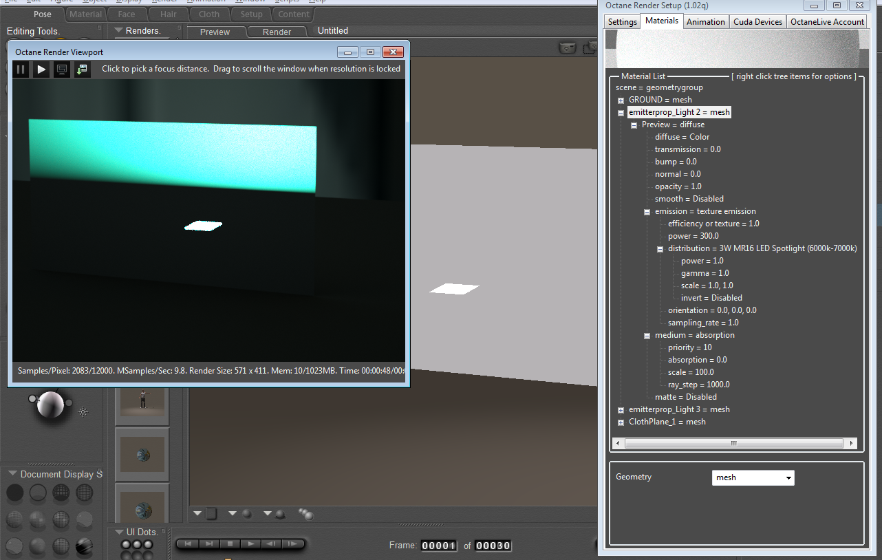

A bit more explanation about the IES light direction and single sided plane emitters created from the poser spot lights
If I create a spotlight facing down (xrotate at -90, rest 0), add an IES image to dstribution, then convert this one to an emitter with the script, I get a nice spotlight, everything works as expected.
Now I rotate the light to face upward (*xrotate at 90), refresh and render. The light disappears. The emitter plane has rotated with the light so should be facing the correct way, but it is not. If you add another light, you can see that in the render the normal is still facing the same way, in Poser it is facing the other way
In the attached screenshot
- 2 spotlights, one facing up one facing down. In the wireframe you can see one of the 2 planes (on the left) the other is facing the other way and is not visible (correct since they are single side objects). The render shows only 1 spotlight, but clearly both emitter planes are visible. If you either rotate the image in octane or rotate the plane in poser will render the light
