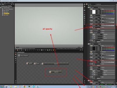

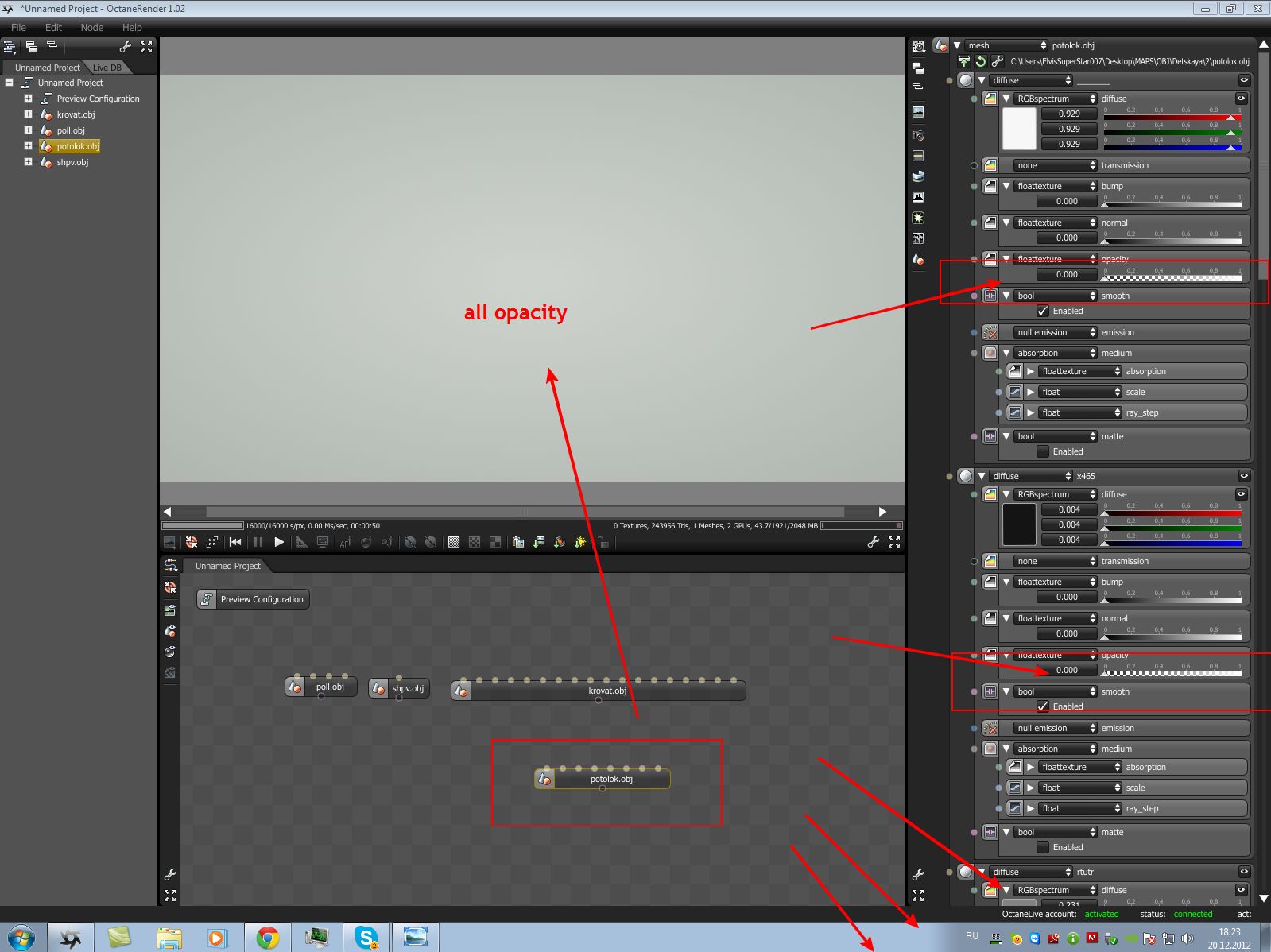

bag 1.01 1.02

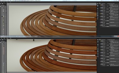

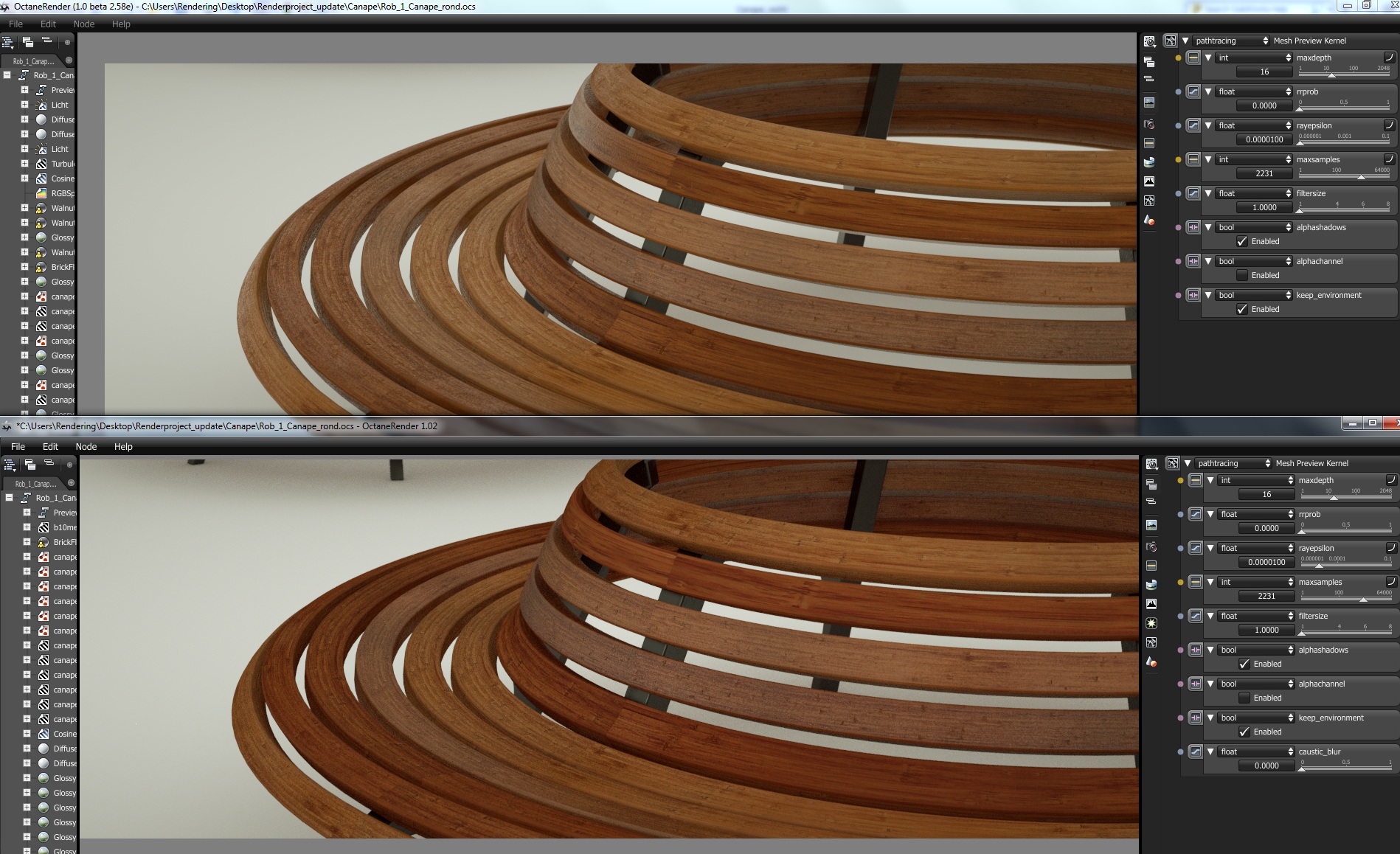

Does the new octane 1.02 version get textures different? Does anyone experience the same?
Here`s a comparison: upper screen is 258.e, below 1.02:
Octane 2022.1.1 nv535.98
x201t - gtx580 - egpu ec
kavorka
Posts: 1351
Joined: Sat Feb 04, 2012 6:40 am
whersmy wrote:Does the new octane 1.02 version get textures different? Does anyone experience the same?
The way Octane handles glossy materials has been changed, so that might be what is causing this difference. You should now have a Fresnel slider at the bottom of your glossy material that can be used to get some nice effects and will give you an image closer to what you had with 2.58e

I have not yet tested 1.02, but with 1.01, I can open previous scenes created with 1.0 or 2.58e without noticing any trouble.
Refracty
Posts: 1599
Joined: Wed Dec 01, 2010 6:42 pm
Location: 3D-Visualisierung Köln
yip, different fresnel reflections

Hi all,
Great stuff as usual ;) (ok, the opacity bug from obj is quite boring, solved by not import material)
