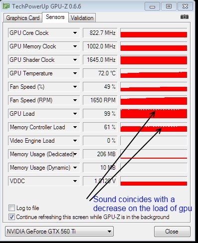

franbec
Posts: 18
Joined: Sun Jan 31, 2010 11:20 pm
Location: Spain
The sound coincides with a momentary decrease of the load of the gpu, not overload. can be seen in gpuz utility.
Win 7 x64 | Gainward Gtx560ti 2gb | CoreI5 2500k 16GB |Blender 2.49|Sketchup|
