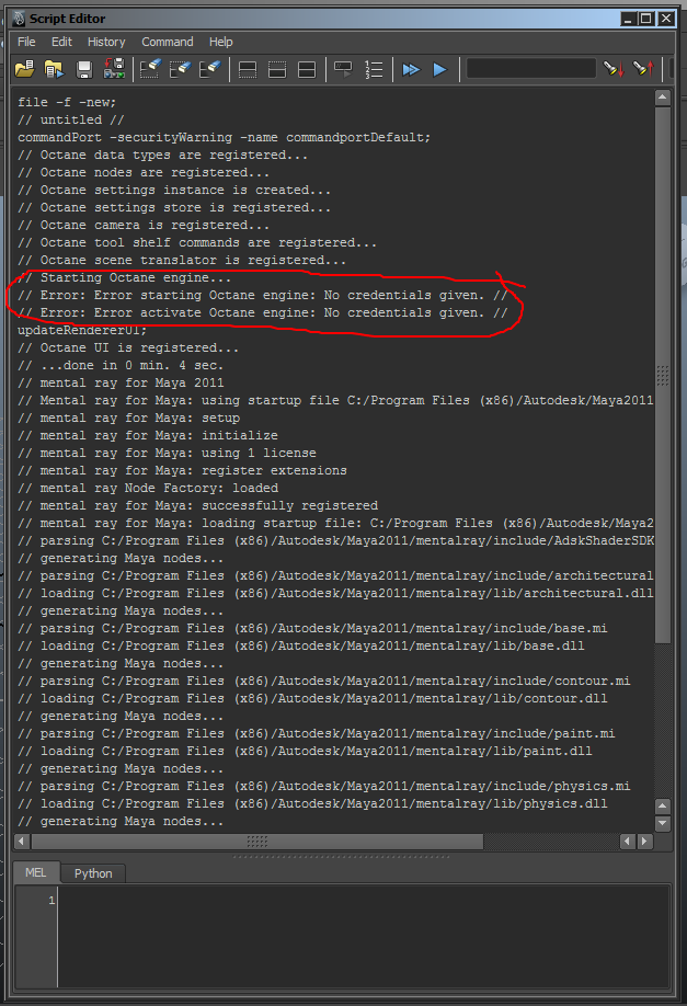

Jimstar - I did another render and the error you referred to is what it said see image below, this was captured at the end of the second animation frame

jmfowler wrote:Jimstar - I did another render and the error you referred to is what it said see image below, this was captured at the end of the second animation frame
Thank you very much! It is what I needed.:)
Now, thanks to this log, I can tell you what is the exact reason: it is really the engine issue. I don't think it is the big deal (as the rounding is very small), but anyway it is the fact: it seems that the engine rounds a little the counted samples when rendering, so if you render some big amount of samples it becomes "visible". E.g. if the engine sees that the next iteration will give more samples than needed - e.g. you already have 7997 and the engine sees that the next iteration will give 8016, it stops refreshing the image rounding it to the lowest value... It is only my assumption about the engine's algorythms, but it seems that it is something like this...
I just have added the workaround which catches if it happens and treats this frame as finished.
