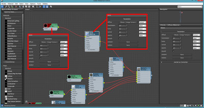

Hello texture problem on max 2013 max OR rc3/rc2/rc1
the texture is black in wieuport and rendering??

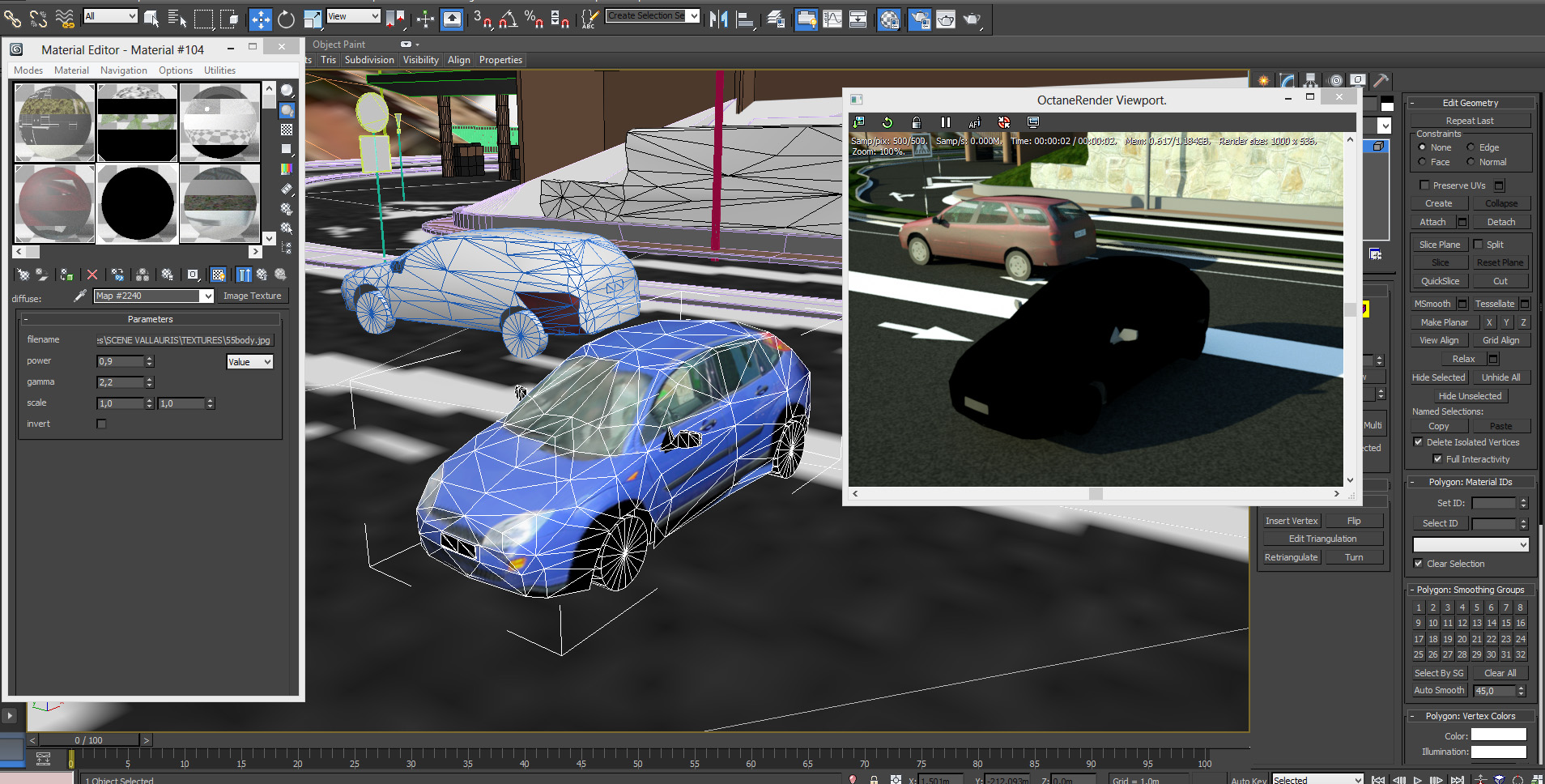

jauffrey
Posts: 15
Joined: Sat Aug 06, 2011 4:46 pm
Karba wrote:
jauffrey wrote:Hello texture problem on max 2013 max OR rc3/rc2/rc1
Could you show your texture statistic?
nothing special classic!

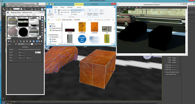

jauffrey
Posts: 15
jauffrey wrote:
Even with a simple cube texture and a simple jpeg 751x768 24b
configuration and 3xgtx590 1xgtx580 3930K Win 8/7 64b

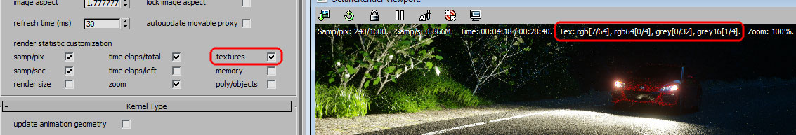

Karba
Posts: 2300
jauffrey wrote:
Karba wrote: Could you show your texture statistic?
I mean this statistic

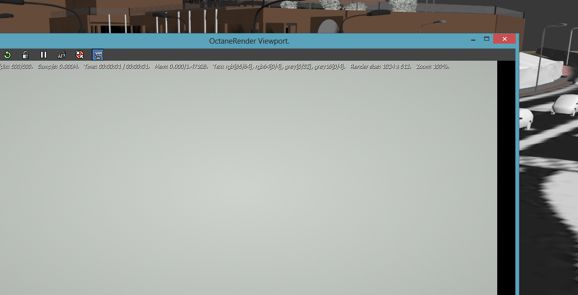

jauffrey
Posts: 15
Karba wrote:
I believe that forgiveness jai including the limitation of 64 textures
size and limited as
