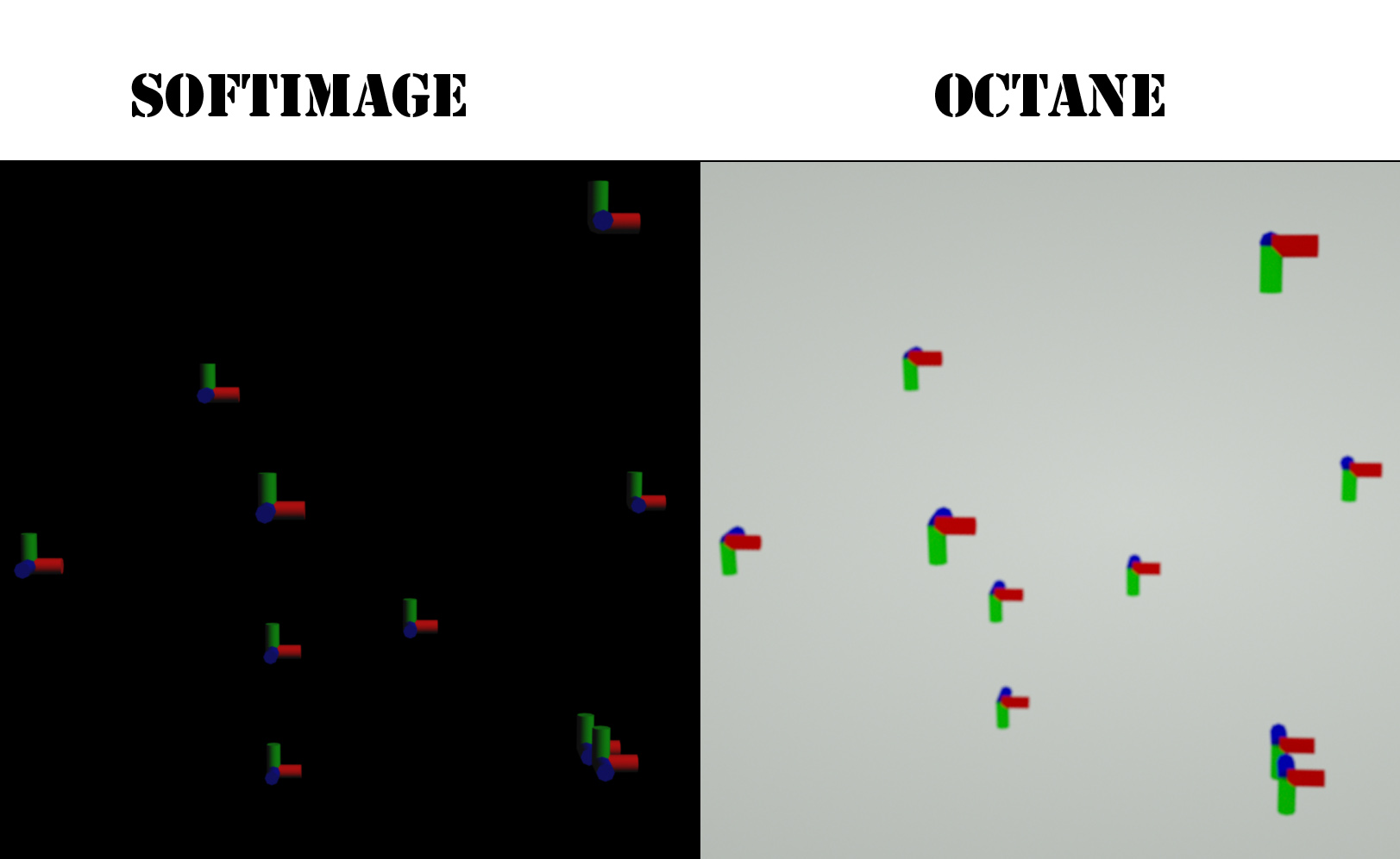

I keep having orientation problems with this new converter version.
Everything comes upside down, I usually remediate this problem by putting a placement node before the scatter node with a 180 degree rotation on the X axis. But I can never get the exact same rotation as on softimage.
Am I doing something wrong?

Hello stephan
Here is a sample scene with a sphere emitting cones aligned to the surface.
Softimage scene, obj's, csv and ocs file attached
I uninstalled the Soft2octane addon, reinstalled, and replaced the dll with the updated one... it still has the wrong orientation...

That´s wired.
Have tested your scene with the debug dll and it works. With the release dll, it fails.
With the Softimage 2011 SDK you set an quaternion via ( x, y, z, w ) with 2013 via (w, x, y, z ). Or vice versa...
Maybe it´s possible that different Softimage applications use also different versions. So the plugin works with 2011 but not with 2013.
Or it works with 2013 and not with 2011. Must check it.
Realy wired...
Here a version which is running with 2013.
