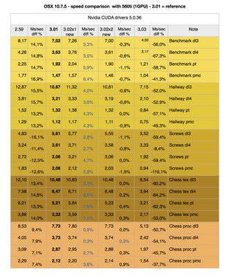

hi,
just to mention that i have installed a fresh copy of os x 10.7.4 on a secondary hd, with no toolkit and cuda drivers 4.2.10 and the results with 3.03/3.02x1/3.02x2 are exactly the same as with 10.7.5 and cuda 5.0.36.
ciao beppe

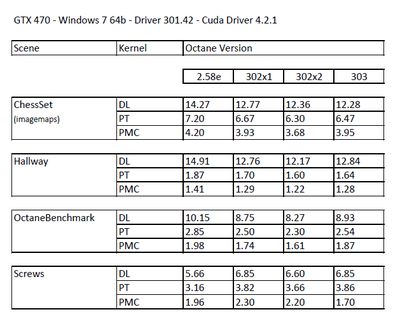

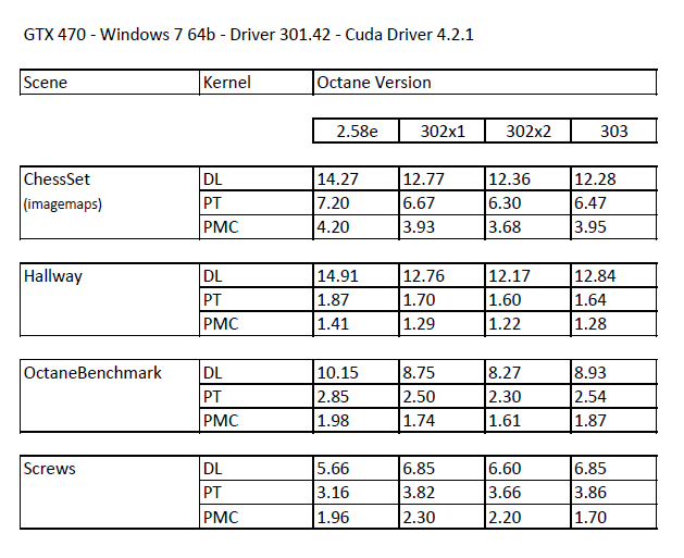

Here we go, hope it helps
Win 7 64bits / Intel i5 750 @ 2.67Ghz / Geforce GTX 470 / 8GB Ram / 3DS Max 2012 64bits
http://proupinworks.blogspot.com/

Posts: 10621
hi,
yeah, at a first look seems that the issue is gone :D
a bit better with 3.02x 1 then 2 but i will post all the results during the day ;)
thanks a lot
ciao beppe
