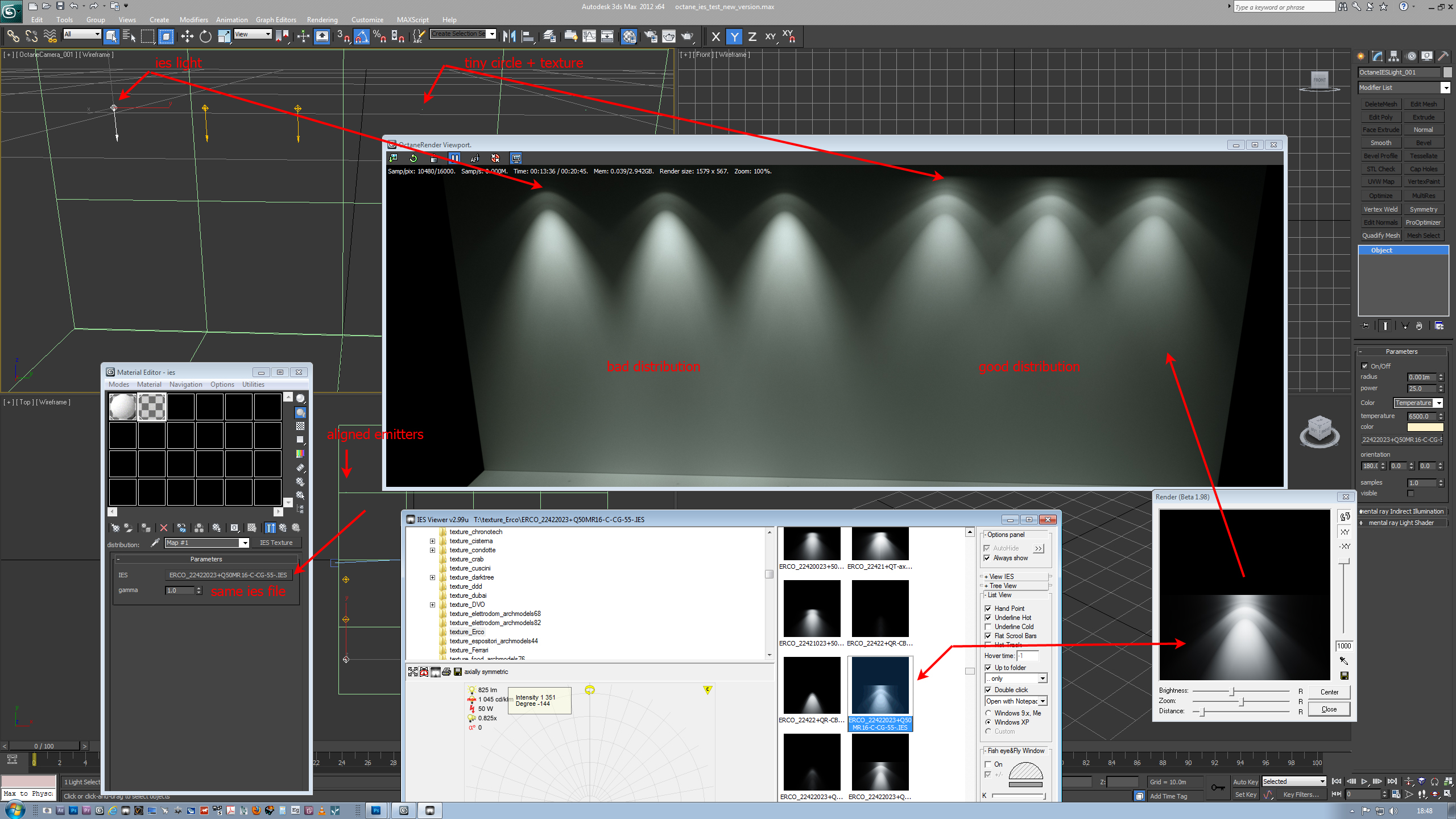

thanks for sharing, Gabrielefx.gabrielefx wrote: I noticed a wrong ies distribution using Octane ies lights..
Is this ies simmetrical?gabrielefx wrote:Hi Karba
I noticed a wrong ies distribution using Octane ies lights. Ies light distribution is clamped on the top (no matter what is the power)
I never used Octane ies lights but only my method.
In fact no problem using circles with diffuse mat+blackbody+ies texture
I don't think it's a 3.02 problem.
See the example below.

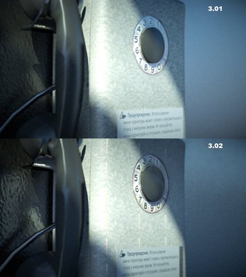

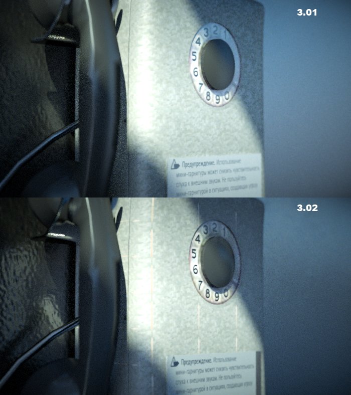

Do you use last driver version?suvakas wrote:I ran into a strange texture bug.
Weird stripes appeared on top of my texture. It's with glossy material. It looks a bit like normals issue, but turning smoothing on/off won't do anything
The uper image is made with previous version of the plugin and lower is with this new release. I made a new material from scratch and even then those stripes didn't go away.
[edit]
Those stripes are borders where the texture tiles/repeats. Those do not appear in prev. version and it also works with other renderers. So it's a bug!
It also shows up in material preview if I scale/tile a bitmap texture. With other texture maps too.

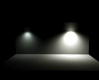

It was always like this.ttaberna wrote:Hi
I also noticed something strange with the lights today...
Here is a test 2 ies lights completely same settings except 1 is set temperature 6500 (left) and the other one is set to color 255,255,255 (right).
But even if the intensity of the light is the same the result is quite diferent
Maybe it's been dicused before...
