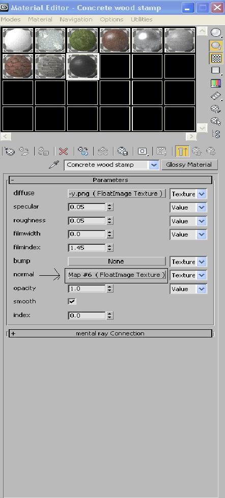

i have a question, what image i need load in the option of normal ? a really normalmap or diffuse texture or gray scale map , becouse i can't see the relief in the scene, please, help me
thank you, i add image
slot normal
slot normal

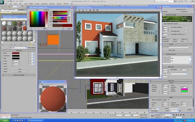

hi, is the same problem for me, the color again, looks so different, in the slot is a color, but when i apply is more clear the tone, why happen this ?
regards
thank you karba
color different

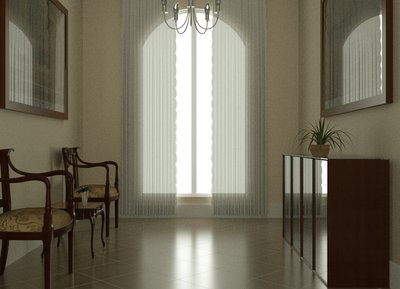

again noise in the image, maxdepth 8. maxsamples 3000, size 1229 x 887, pathtracing
why happen this ?
thank you if some one can response me
noise again
noise again

merid888 wrote:hi, is the same problem for me, the color again, looks so different, in the slot is a color, but when i apply is more clear the tone, why happen this ?
regards
thank you karba
We have done some work on improving the color accuracy of Octane. In the next release colors will look much better, especially reds and deep blues.

merid888 wrote:again noise in the image, maxdepth 8. maxsamples 3000, size 1229 x 887, pathtracing
why happen this ?
3000 is not enough. And use pmc instead of path tracing.

thank you for response me roeland and thak you to you too karba, i'll practice pmc and more maxsamples

try also to use light portals and see if it improves your render.You could possibly achieve a speed up, plus as karba mentioned use pmc in combination. And see what results you can get.
