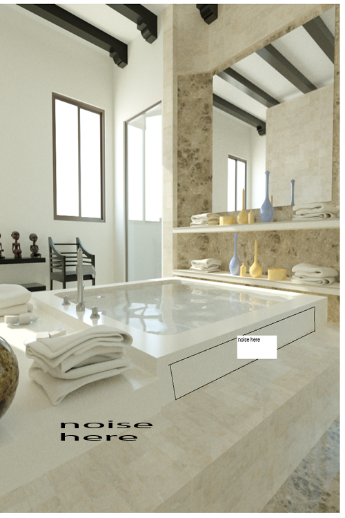

I think that this noise it's normal....merid888 wrote:add image with text indicating noise
I have always noise in my images but I can reduce it
You should compare Octane standalone + Octane for Max produced renders with the same parameters, materials, lights, etc.
Probably the sample parameter for glossy materials will help us

						Hi merid888 if you want to have your scene with less noise increase max samples to 64000 or 80000 it will be long hours of rendering but actually its the physically lighting calculation otherwise if you want to have your scene in less time you have to upgrade your machine with 2000 or more cuda cores. My scenes take 4 to 5 hours to produce less noise but it is much much faster tan maxwell i prefer  4 hours than 12 hours of maxwell.
						- gabrielefx
- Posts: 1701
 - Joined: Wed Sep 28, 2011 2:00 pm
you can't set more than 64000 samples...relox wrote:Hi merid888 if you want to have your scene with less noise increase max samples to 64000 or 80000 it will be long hours of rendering but actually its the physically lighting calculation otherwise if you want to have your scene in less time you have to upgrade your machine with 2000 or more cuda cores. My scenes take 4 to 5 hours to produce less noise but it is much much faster tan maxwell i prefer 4 hours than 12 hours of maxwell.
