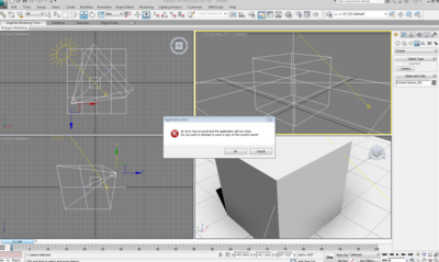

Crash Report.
3ds Max Design 2012
Octane Plugin 2.56b
Win7 64 bit
16gb ram
GTX460 Graphics Driver Version 285.62
Wacom Intuos 4 Tablet 6.1.6-7
3d Connexion Space Pilot Pro 3.3.107.0
Create box in 3ds Max Design
Create Octane Camera
Select Camera
Right Click - select set view to camera
Total Crash of 3ds Max Design - saves a recovery file - recovery file will open to the point of re orientating the view to the camera where it crashes again.
This is the same crash as previously reported, although there is a noticeable difference in the time it take to crash from the original plugi (almost instantaneous) to thw 2.56b version - now take 3 or 4 seconds before crashing
Any advice?
