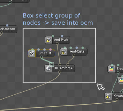

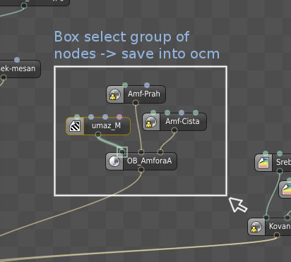

Can we have this little improvement in the future release;
* the option to box select a group of nodes (which constitute one logical material) and save them together into an .ocm
* since they are selected, we could move them around together, not just one node at a time
* right click -> import nodes at cursor location (instead of global coordinates at which the nodes were saved into ocm)
* we would really need the option to save an .ocm without embedding textures. Saving 4k / 8k textures uncompressed is so damn wasteful without reason, and brings the problem of unacceptably long saving times for .ocs projects when you have imported nodes with embedded textures.
