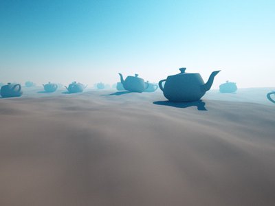

I have attached a simple scene

I'm here from the MODO sub-forum, so I can't open the .max scene. But if I understand it, you need two volumes: one around the scene and another around the camera. Are both mesh faces inverted, or just the camera-surrounding mesh?
EDIT: Also, I noticed that even in heavy fog, shadows from the sun are still sharp.
glimpse
Posts: 3740
riggles wrote:I'm here from the MODO sub-forum, so I can't open the .max scene. But if I understand it, you need two volumes: one around the scene and another around the camera. Are both mesh faces inverted, or just the camera-surrounding mesh?
only sphere should have inverted normals & the same material as bigger box.. - basically the sphere acts as a hole without a material..like an empty space in a cheese =)
as for shadows, simply make sun size bigger (if I remember good & not mistaking other engines) and shadows will get softer =)
