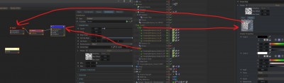

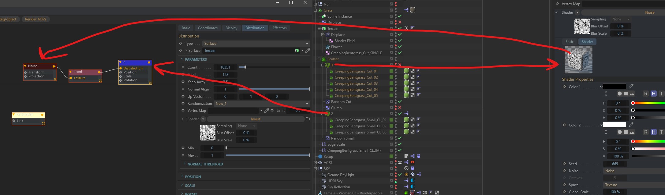

Thank you for incredible update ! I don't know if that "feature" worked before but now it is possible to share the same node between many Scatters even without the need of use RefShader. This is very productive. Just using simple mouse dragging. Changing node parameter in one Scatter change it in all others :
Scatters_share_node.zip
(460.43 KiB) Downloaded 100 times

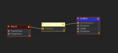

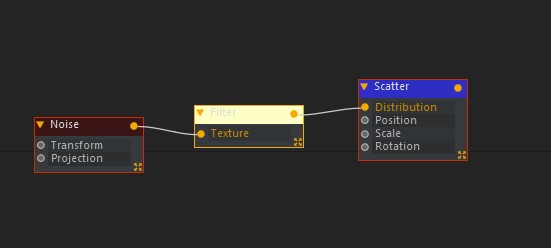

And C4D nodes works inside Scatter for manipulate noises :
I think that they should be added to the C4D section in Octane node editor - colorizer, filter, fusion, posterizer if they works now.

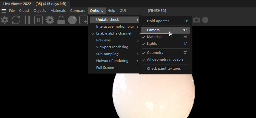

i am writing a script "selected object as camera", mostly used for lighting
i don't know how to write: uncheck camera
I have learned some of the C4D SDK, but not familiar with octane
SSmolak
Posts: 1157
Joined: Sat Feb 07, 2015 5:41 pm
Location: Poland
freeter_e wrote:
aoktar wrote:New build(R5) with same SDK that's available. Enjoy it!
hi, where can i find octane sdk?
It can be done using Xpresso. Also there are some scripts from AR : https://github.com/aturtur/cinema4d-scripts
You can do that by default too : https://www.youtube.com/watch?v=JckDqspwIkc
Architectural Visualizations http://www.archviz-4d.studio
freeter_e
Posts: 40
Joined: Fri Apr 05, 2019 9:12 pm
SSmolak wrote:
thank you for your response.
i know C4D have a function button "selected object as camera"
but my need is : "selected object as camera" + octane live viewer camera uncheck, and some custom settings.
Code: Select all
#octane live viewer, camera uncheck
import c4d
ID_OCTANE_LIVEPLUGIN = 1029499
def main():
    bc = doc[ID_OCTANE_LIVEPLUGIN]
    bc[c4d.SET_CHECK_CAMERA] = False    #bc[3219] = False
if __name__=='__main__':
    main()
    c4d.EventAdd()
i don't know why it doesn't work
