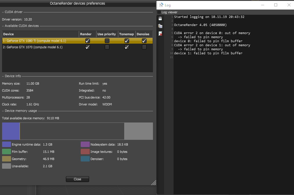

Studio drivers are not supported for 980ti and earlier right?
And R7 is constantly says no memory, but statistics says I have more than 3 gb extra!
Maybe driver issues, will try to rollback. Is anyone having similar issues?

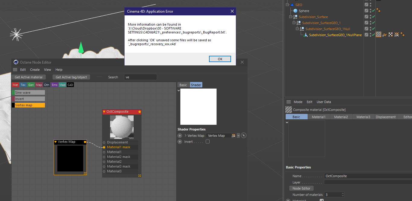

In R21 the vertex weights are crashing on me, does anybody else have this problem?
Using the latest studio drivers on a 1080ti.

Terryvfx wrote:In R21 the vertex weights are crashing on me, does anybody else have this problem?
Putting a scene that will always help me to help you. Also bugreport.zip and c4doctanelog.txt with activated logging.
