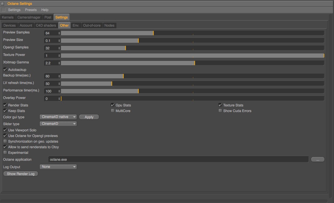

Ok. Do this tests:
1a-Activate "async. updates on settings->other". Switch to on view layout. And do same actions with A6. Netrender=Enabled.
1b-Disable "async. updates on settings->other". Switch to on view layout. And do same actions with A6. Netrender=Enabled.
2a-Activate "async. updates on settings->other". Switch to on view layout. And do same actions with A6. Netrender=Disabled.
2b-Disable "async. updates on settings->other". Switch to on view layout. And do same actions with A6. Netrender=Disabled.
Give me the results.

i meant "syncronisation on geo. updates". Sorry
3.00 Alpha 6
Sync Geo - Enabled|Network - Enabled = No Crash
Sync Geo - Enabled|Network - Disabled = No Crash
Sync Geo - Disabled|Network - Enabled = Crash
Sync Geo - Disabled|Network - Disabled = No Crash
(Restarted Cinema for each test)
Ran each twice with same results.

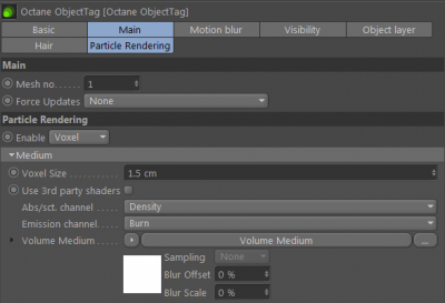

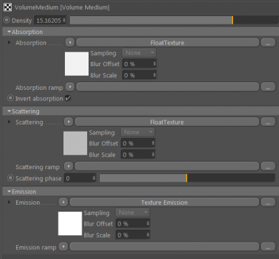

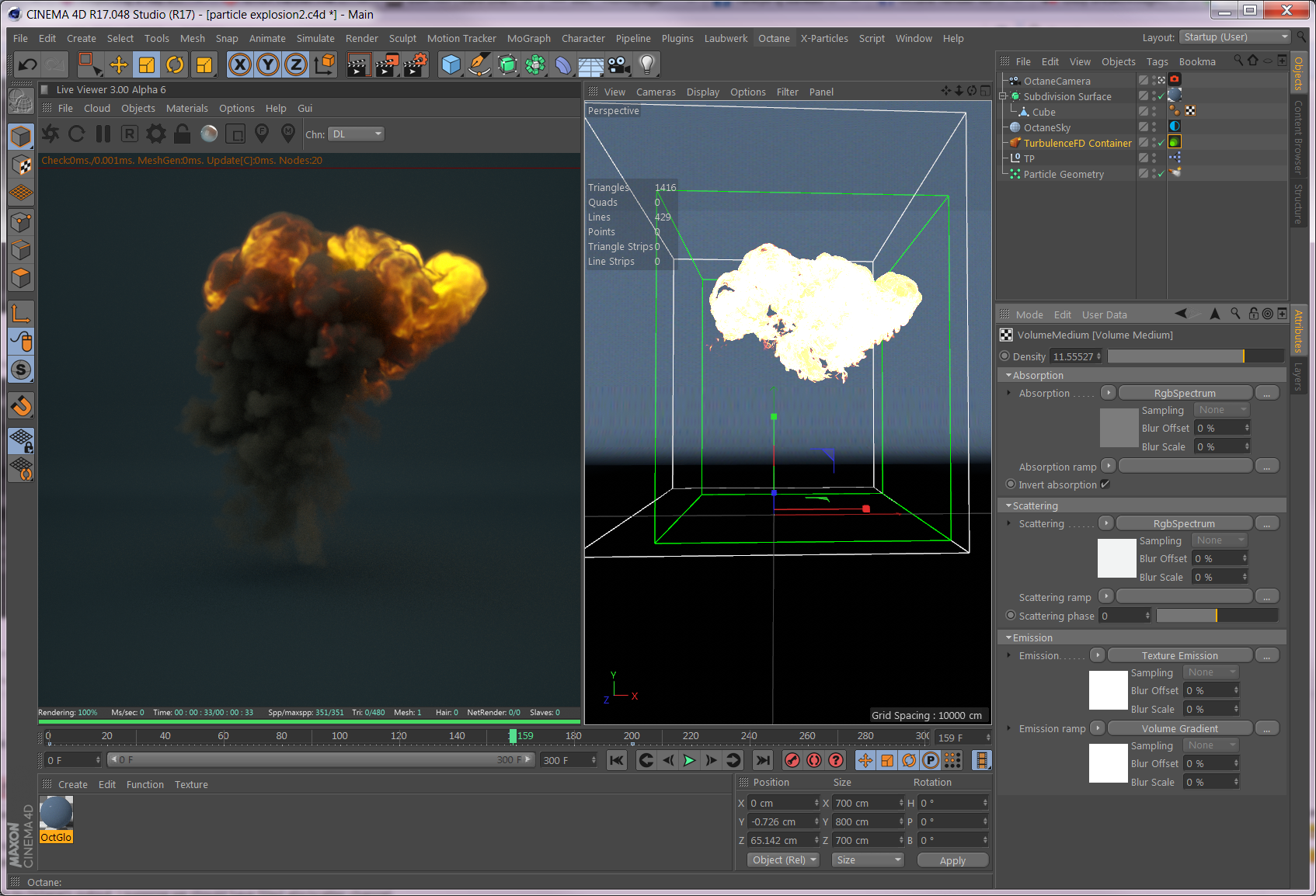

Not a problem. It's a bit tricky and experimental to make proper pairs from TFD to Octane. If you add and object tag it would try to initialize the proper settings for you as TFD's settings.krofl wrote:Might be a stupid question but does anyone know why the renders are coming out black? Just installed the Alpha6 version
It looks to available channels of tfd and also render smoke/fire shader settings.
In Medium tab, we should set which channel goes to Octane's output. I suppose we should have filled abs/scatter channel. If you want to see emission effects, need to have a texture emission in Medium Volume, also rgb/float/etc.. textures in Scatter/Absorption slots.
