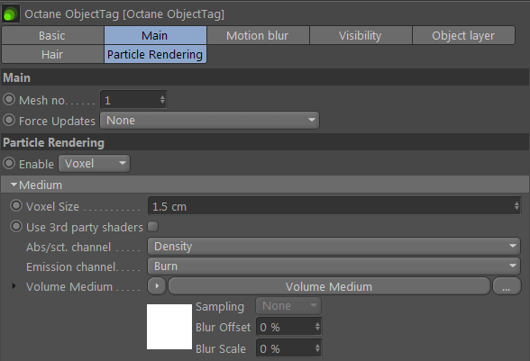

Might be a stupid question but does anyone know why the renders are coming out black? Image Just installed the Alpha6 version
Posts: 16068
Location: Türkiye

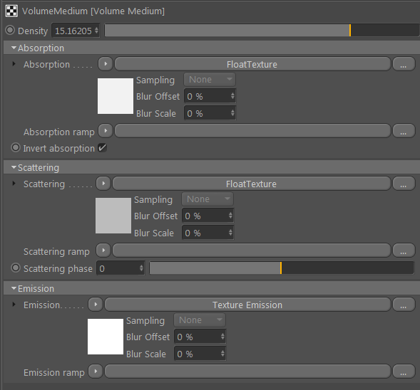

krofl wrote:Might be a stupid question but does anyone know why the renders are coming out black? Just installed the Alpha6 version
Not a problem. It's a bit tricky and experimental to make proper pairs from TFD to Octane. If you add and object tag it would try to initialize the proper settings for you as TFD's settings.
It looks to available channels of tfd and also render smoke/fire shader settings.
In Medium tab, we should set which channel goes to Octane's output. I suppose we should have filled abs/scatter channel.
If you want to see emission effects, need to have a texture emission in Medium Volume, also rgb/float/etc.. textures in Scatter/Absorption slots.
