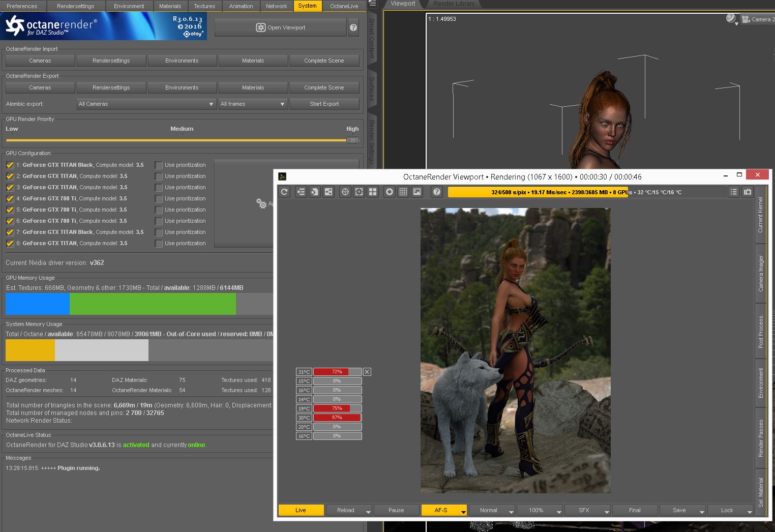

Just test the 3.0.6.13 and on the system tab, the GPU selection is not taken into account (even when hit apply configuration).
Ex : I select all the 8 GPU, at render title, there is 8 GPU but only 3 temperature displayed. and OctaneGPU monitoring gadget show only 3 GPU full load.
Can you tell which of the 3 GPU's are being used? Does GPU-Z show the same result? Was this working OK on the previous release?

The V 3.0.4.11 works fine, during rendering, I can select or deselect GPU in realtime and see on "OctaneRender GPU mini Monitor" what happened (very cool this gadget).
On the V3.0.6.13, It start with GPU I select with the previous version, and I can select other GPU, but there seems no effect on the rendering time/speed. I can even uncheck all and apply configuration, and the rendering goes fine with initial GPU "selected" (check on GPU monitor).
The workaround is to start an athother DazStudio with previous version of OcDs, and check GPU I want, and restart the new one...
Edit : just go back to V2 to rendering animation as V3 make some freeze using PCIe 1X, and found something interesting, V3 seems to take more VRAM than V2 (with settings default 8 parrallel and 8 tiles in V3). Ex for one of my scene up to 2.5GB (using resize texture to fit my 780Tis), in V3 I have only 230MB free. Back to V2 and I have up to 800MB free with the same scene.
Can you pls export to ORBX and import that file into Octane Standalone and see if Octane Standalone will render with more than 3 GPU's?
Also, yes, Octane 3 uses more VRAM when Parallel Samples is > 1.
Paul

Hi Paul,
No problem when exporting to StandAlone 3 alpha 6.
Here my step :
- On V2 : check only 3 GPU
- On V3.0.6.13 : see that 3 GPU are selected. Check 2 more GPU, apply and test render : Only 3 initial GPU works (monitor on GPU monitor)
- Export to StandAlone : I can select all the 8 GPU and all work fine.
Here my step :
I have uploaded a build which provides some debug info. Pls install it, then load and start rendering your scene, then on the System Tab->GPU Configuration click the Apply Configuration (confirm that only 3 GPU's are rendering). Then exit DAZStudio and post the C:\Users\USERNAME\OctaneRender\debug.log file here.
https://render.otoy.com/customerdownloa ... _Win64.exe
