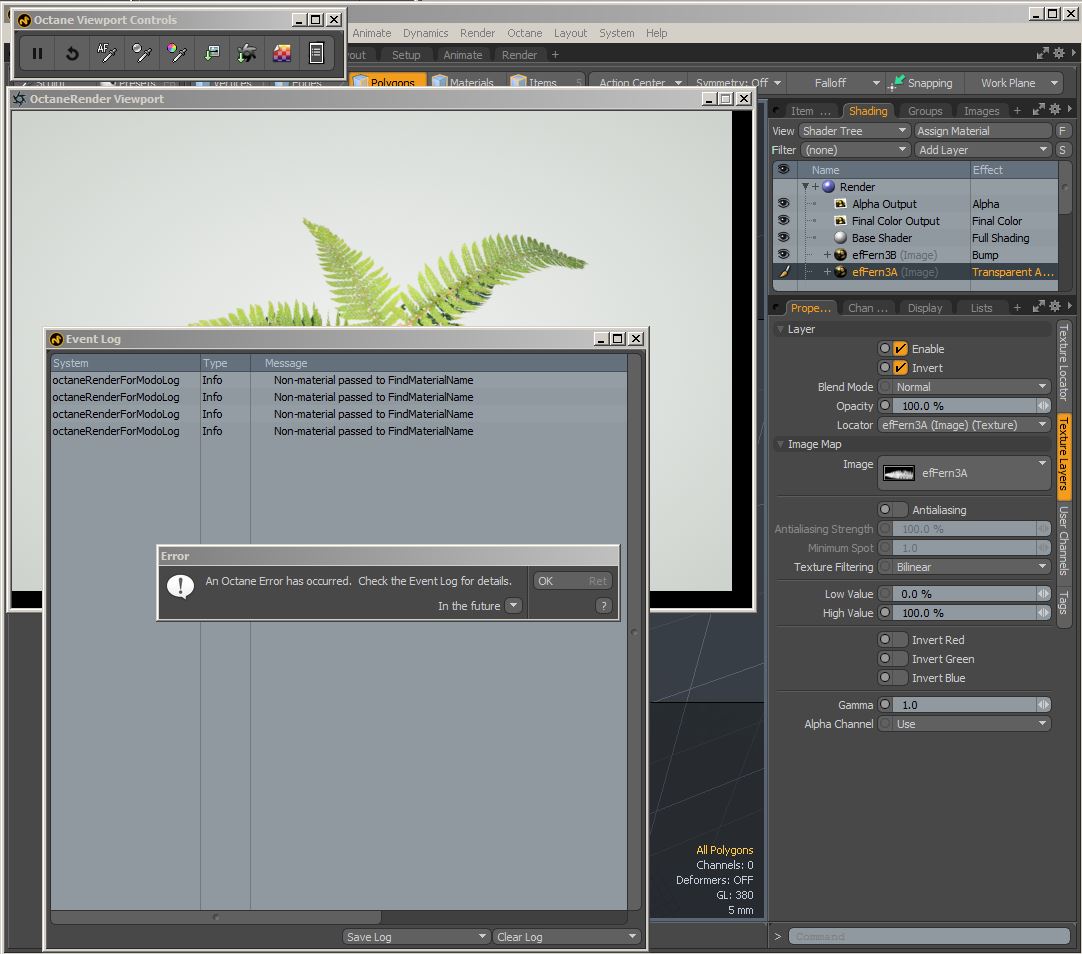

When adding images as textures and trying to changes the settings, Octane will give an error on any settings I try.
I Zay - I have not been able to replicate this. Does it happen on a new scene for you - or just that scene. Does restarting Modo fix the problem?
