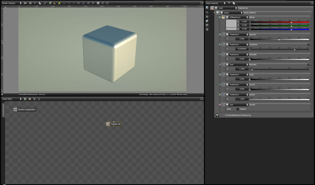

What you mean are the user normals, i thing.
Will fix it to write they too...
When you set it to 0°, the smooth option in Octane is on, but the user normals are shown as smooth is off
To test it, create a cube and export it.
Open the obj-file with a texteditor and type in under the g option a "s off"
That should tell Octane, that the smooth option should be off, but for the first mesh, it is ever on.

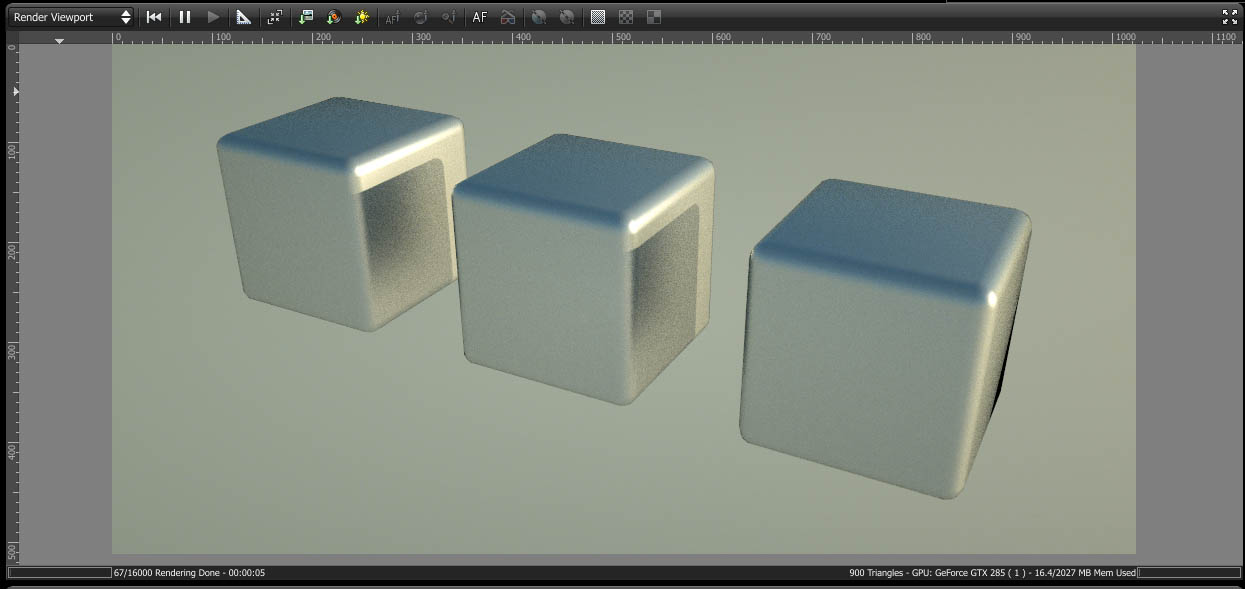

I got example whith something else.
ill paste it here in couple of minutes since its rendering

Try to export 2 cubes and set after all g options the "s off" flagmlody47 wrote:I got example whith something else.ill paste it here in couple of minutes since its rendering

Try to change the s option in "s 1" for cube and "s 2" for cube2.
Like this:
Code: Select all
o test.obj
mtllib test.mtl
g cube
s 1
#begin 26 vertices
v -0.277778 -0.277778 -0.277778
v 0.277778 -0.277778 -0.277778
g cube1
s 2
#begin 26 vertices
Also, the smooth on/off option in Octane works only from the second mesh. The first is ever smooth on.

Hm,Amplitude wrote:I tested it right away and the bool smooth is off in Octane. Is it what you expected?
maybe Octane reads the user normals and switch the smooth on or off...
Hope i can implement to write they too..
