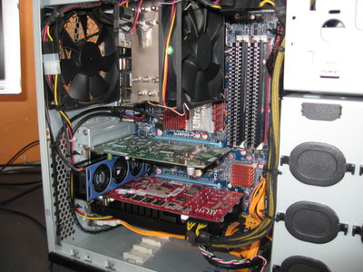

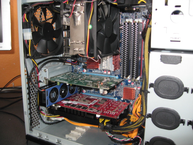

Hi, welcome to the forums. I have the same card and I like it for Octane.
I am a little unhappy though with the way the fan shroud ventilates mostly into the case.
I did have much the same arrangement with a GTS250 but the 460 runs quite a bit hotter and a fair bit of heat rises from the back to my other card I use for display.
This is actually my main concern.
At the moment I have removed some slot covers and pushed in a spare ram fan I had to pull the hot air out from between the cards - and I can tell you it is definitely warm air coming out the back.
I have two fans in the front of my case but the air really wasnt circulating enough to the bottom or between cards
I experimented a bit and this arrangement seemed to work best in my case although I might change it yet..if anyone has a better idea I would appreciate them sharing it.
Pulling the heat off the back of the card was much more effective than trying to boost the air to its fan.
Although the 460 will typically overclock 25% I went for 12% core and 6% memory as a balance between a bit extra speed and looking after the components. I use MSI Afterburner which will draw you a graph of temp as well. Once you have it set up and you are happy it runs cool enough under load you shouldnt need to worry about it.
The Palit doesnt have memory chip cooling so I was playing more safe there.
At the moment with the o/c and 80% fan it runs about 68deg C and my other 58 in continuous use.
I would feel a little happier if I could get that down to say 65 and 55 but I dont think its too bad.
Because the other card isnt doing much I feel it ought to be ~50 but the rising heat and not so good air circulation are giving it a tougher time than it should. It only has a small fan so it is easily 'upset' by extra work.
If you have 67 deg I would say thats ok. If you o/c with fan control and its much the same I would say its fine.
I am pleased with the performance of the 460. I thought the GTS250 was ok for my needs but the 3x speed up is well worth having esp for larger resolutions. I 'll be chuffed if those other 112 cuda cores will come to life with cuda3.2. Man if you have 3x480 using Octane must be so sweet ;)
Anyway hope that blah helps you.
GPU definitely makes unbiased rendering fun. Thats an attribute you cant really express in statistics.
