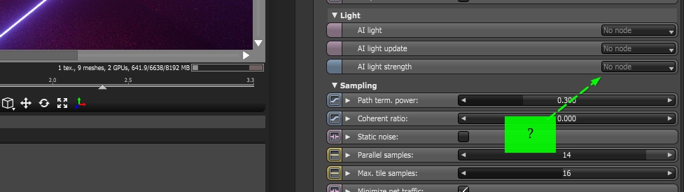

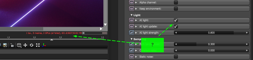

AI Light not working.
When I load scene, AI light not activated. I Change "No node" to default and check AI light and Octane stop render and I get GPU all failed. What am I doing wrong?

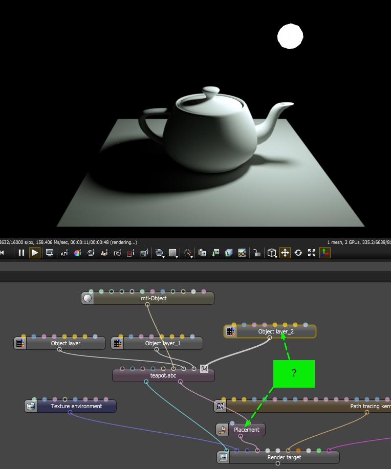

Joined: Tue Aug 28, 2012 5:12 pm
Scene exported from 3ds MAX to ORBX. How can I move Object Layers? I cant connect "Placement" to it.

Posts: 10633
Hi ramone163,
the Placement node can be used with Mesh nodes, not with Object Layer nodes.
So you need a scene with independent mesh nodes, to be able to use the Placement node and move, rotate, and scale your mesh nodes.
If you can export only a single .abc mesh node, as a workaround, you can make a first export with camera and static objects, then export only the movable objects one by one, unpack the .orbx, and import back the single .abc mesh nodes one by one in the first exported scene, connected with a Placement node.
ciao Beppe
