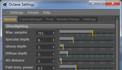

Hi Huv,
do you mean this settings window?
Version 2.12.2 - final (updated on 18.11.14)

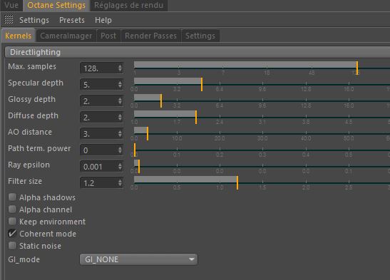

Ho aoktar,
this window.
I define my settings to render an image, jump to perspective view, come back to this render setting window, and all my settings are set to the default values...
Of course, after installing 2.12.1, i've deleted, and created totally new octane startup layout.
this window.

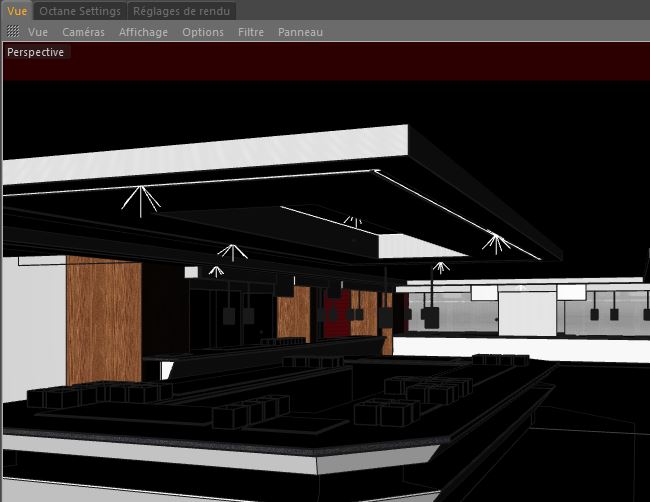

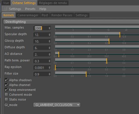

Ok, so :
I'm working on my scene, going to octane render settings and set up what i need (you can see here, how i'v made my layout) : I finally need to change the camera position, so going to my perpective view : Than, i want to go back to my octane render settings, and... reset to their default values :

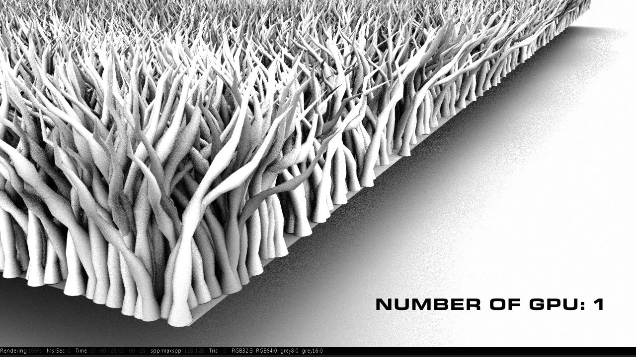

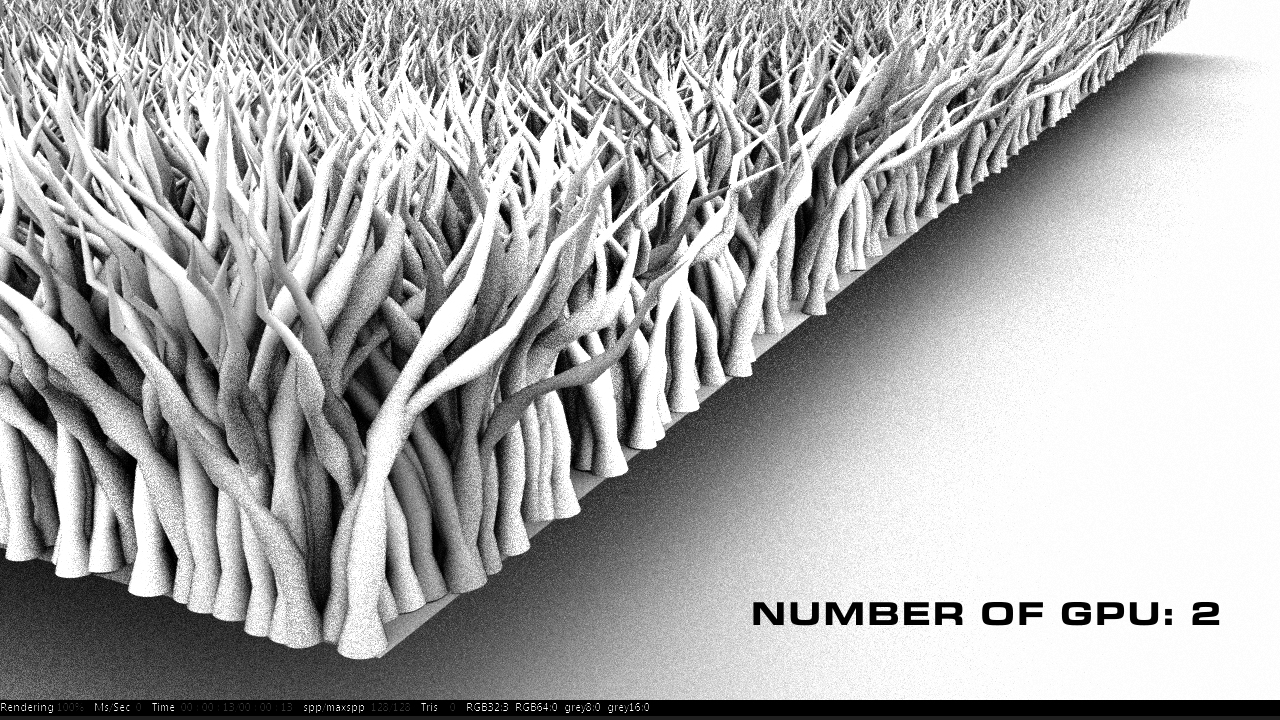

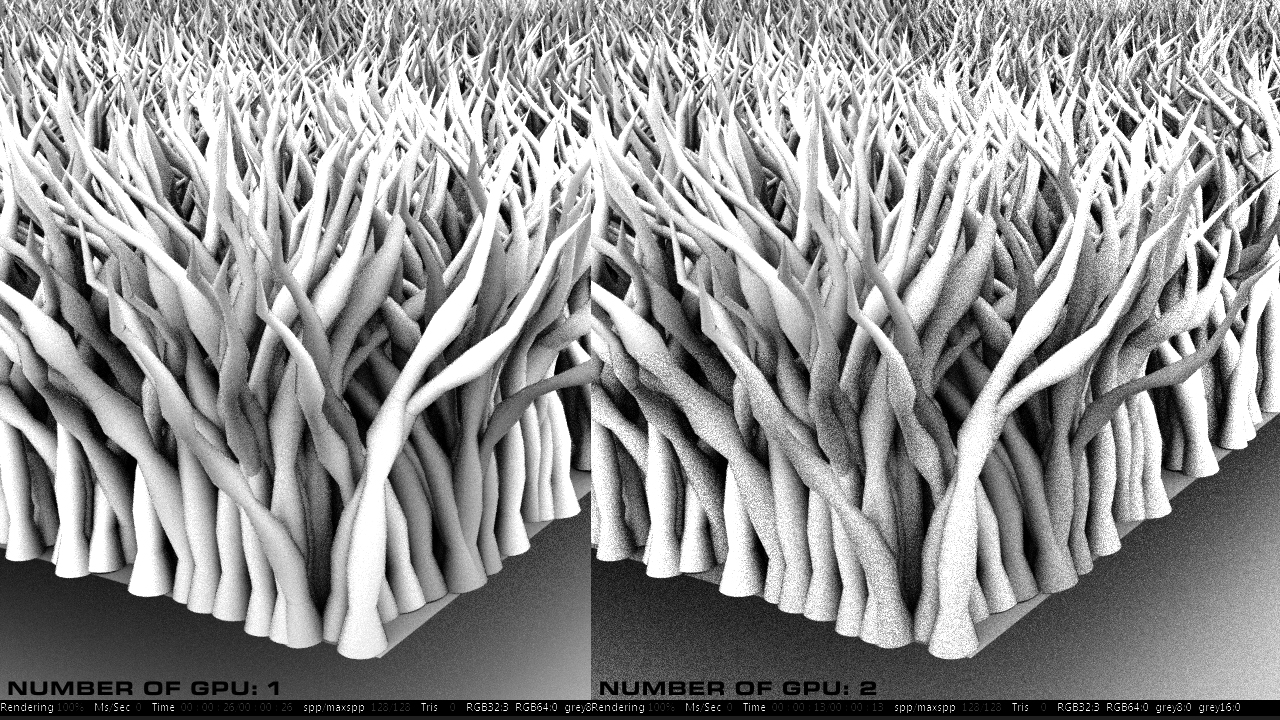

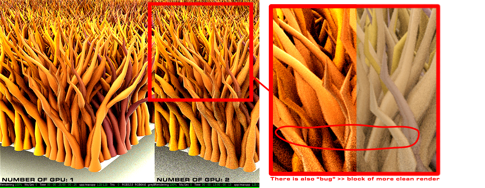

Good Day. My Analysis of what I have found
Looks like with 2GPUs Rendering is right on the small top left BLOCK
- Attachments
- issue_2-twoGpu_gpu.mp4
- my video analysis
- (33.03 MiB) Downloaded 4022 times
- issue.zip
- c4d project file for test2
- (387.08 KiB) Downloaded 256 times
Hi valters,
what's your gpus, nvidia driver/plugin/c4d and os versions?
