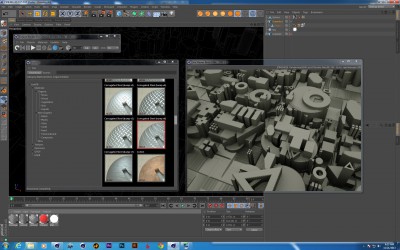

Sorry, how can I show you all those issues? Can I post a screen capture here?
yes, please. But these are mostly wrong usage
