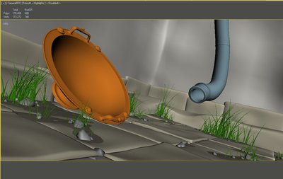

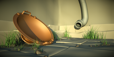

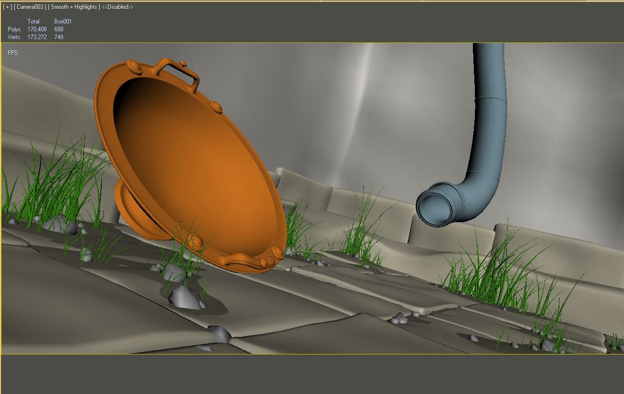

Hi there. I have a small issue with the plugin. It cannot export the proper camera if i rotate the camera in 3dsmax. I use a free camera with some degree of rotation but it get's to be exported as if i didn't rotate it.
here's a viewport grab of 3dsmax and the render i did after i exported the scene with this script to octane. No more rotation.

Florinmocanu wrote:Hi there. I have a small issue with the plugin. It cannot export the proper camera if i rotate the camera in 3dsmax. I use a free camera with some degree of rotation but it get's to be exported as if i didn't rotate it.
Hi, you can use the camera up property in octane, i will try to add this today.
