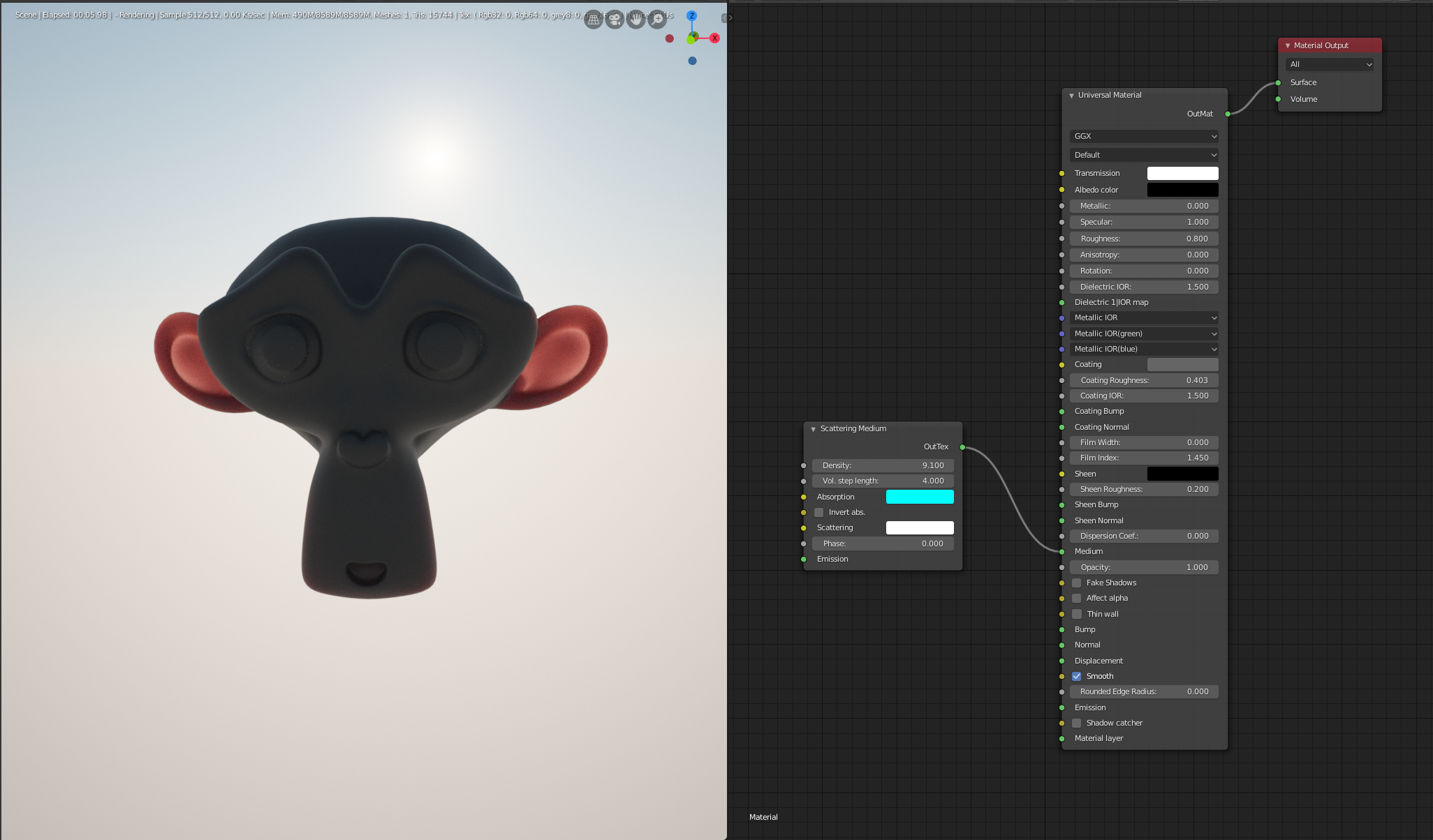

Is there currently a possibility to use Subsurface Scattering or is it not integrated jet?
Normally I should be able to use a Universal shader node and a scatter Medium node to get Subsurface scattering in the path tracer or PMC. but the Medium Node has no effect. Maybe I am just doing something wrong but I tried out a lot and nothing seems to work.

MagicMark wrote:Is there currently a possibility to use Subsurface Scattering or is it not integrated jet?
Have you tried like this?
