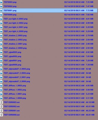

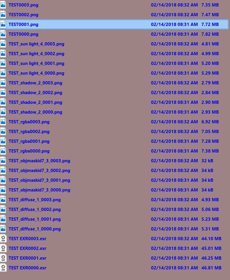

aoktar wrote:Please feedback for latest R19-SP2 and render passes. Saving of render passes works again with latest Service Pack?
Did a quick test with shadows and lights and it now seems to be working fine. Also made .exrs and id layer renders at the same time.
Thank you, aoktar.
PHM
Posts: 21
Joined: Wed Feb 24, 2016 10:38 am
Same here, did a quick test (with 3.07 stable) and it seems to be working.
Single EXR files, saved in folders

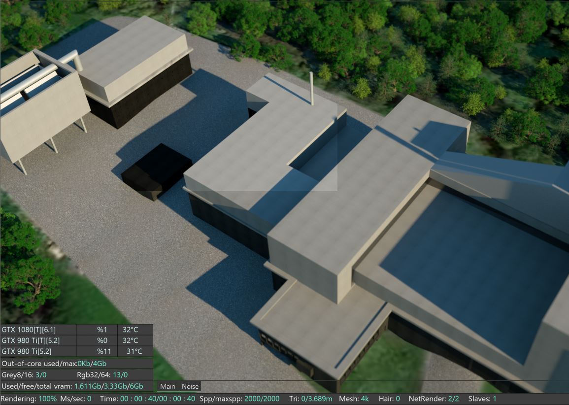

My question has never been replied... Could you have a look at this problem, please? Thanks a lot !
tegatwork wrote:Hi all,
I'm facing an issue with network rendering : everything is ok but the picture ... the part of the picture rendered by the slave is different, as you can see on link below.
Both PCs are running Win10, C4D R19, Octane 3.08.
Master : 2*980ti + 1*1080
Slave : 1*980ti + 1*1060
Any clue?
Ron
Posts: 370
Joined: Sun Sep 25, 2011 7:11 pm
tegatwork wrote:Hi,
Any clue?
Switch off 'Minimize Net Traffic' in Kernel Settings

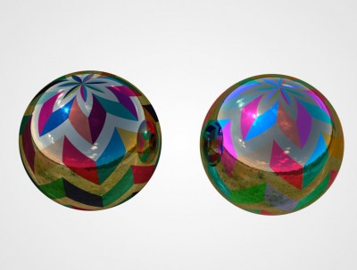

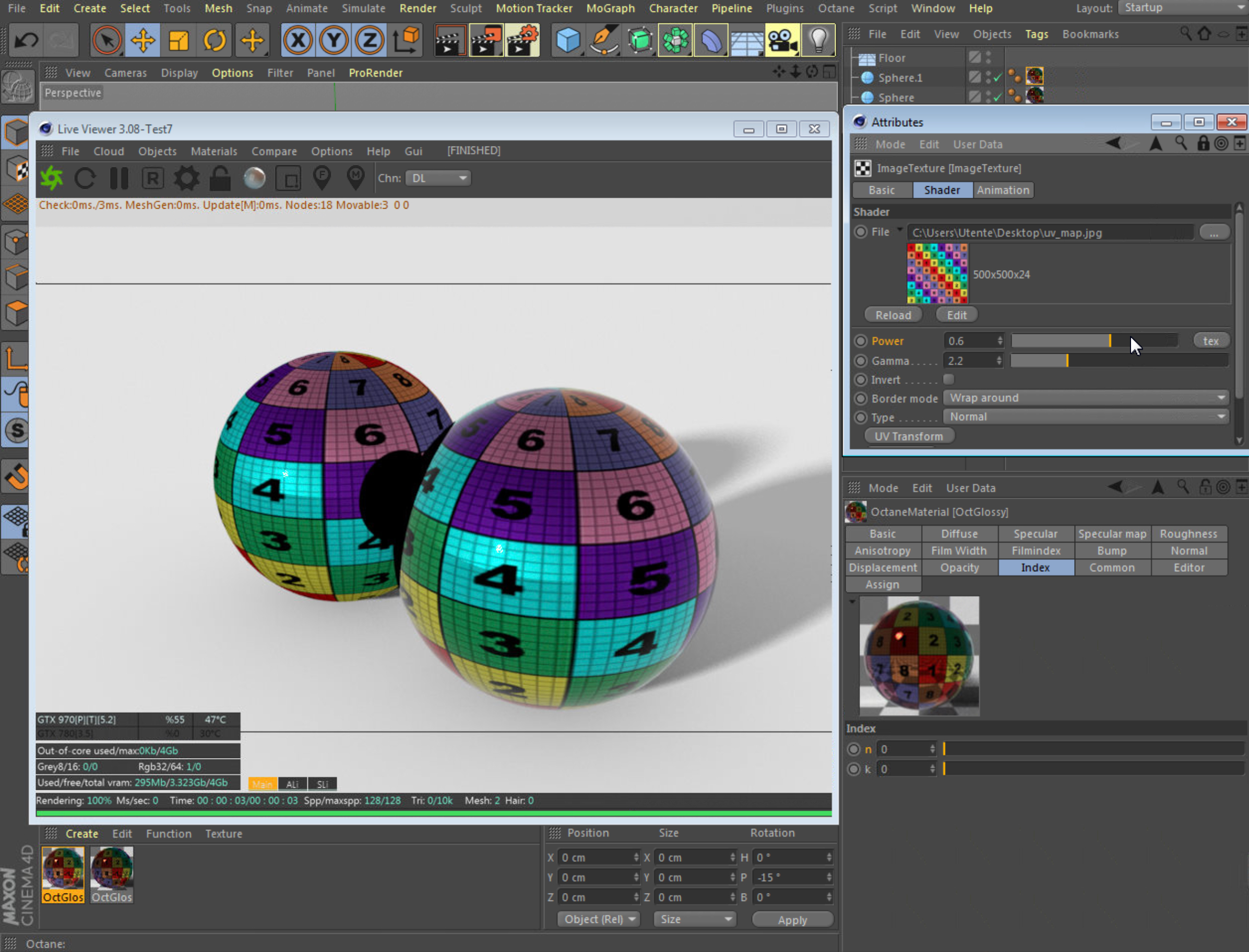

Just checking out the new metal material in 3.08 and I'm curious about how I might go about doing something similar to what I have been doing with the glossy material. I am trying to reproduce an effect I would use with the glossy material Index at 8, Diffuse set to black, and a color image input into the specular channel. I can't seem to reproduce this effect with the new metal material because the color map in the specular channel seems to act very different. Is this a bug or is there a different way to go about this same idea with the new material and keep the colors accurate?
Glossy Material on the left and Metal Material on the right
Posts: 10564
Ibycus wrote:Just checking out the new metal material in 3.08 and I'm curious about how I might go about doing something similar to what I have been doing with the glossy material. I am trying to reproduce an effect I would use with the glossy material Index at 8, Diffuse set to black, and a color image input into the specular channel. I can't seem to reproduce this effect with the new metal material because the color map in the specular channel seems to act very different. Is this a bug or is there a different way to go about this same idea with the new material and keep the colors accurate?
Hi Ibycus,
the new Metal material behaves differently from the Glossy material, and when a complex IOR is set up, the metallic color will get scaled so the brightness matches the Fresnell falloff for that IOR.
So you need to set at 0 the n value, and reduce the power of the Specular image to match the effect that you have with Glossy material and Index 8:
ciao beppe
Ibycus
Posts: 84
Joined: Wed Jul 08, 2015 9:52 pm
bepeg4d wrote: Hi Ibycus,
ciao beppe
Awesome, thanks!
