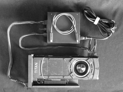

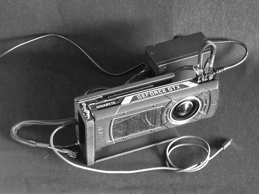

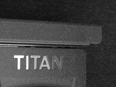

Few shots from latest build I've done recently:
(modified akitio with paint job + SFXL PSU + cable mod)
24 cable jumper & barel plug were made to avoid some mess.
what really surprised, was quick painjob =)
matched original TitanX color & texture perfectly.
