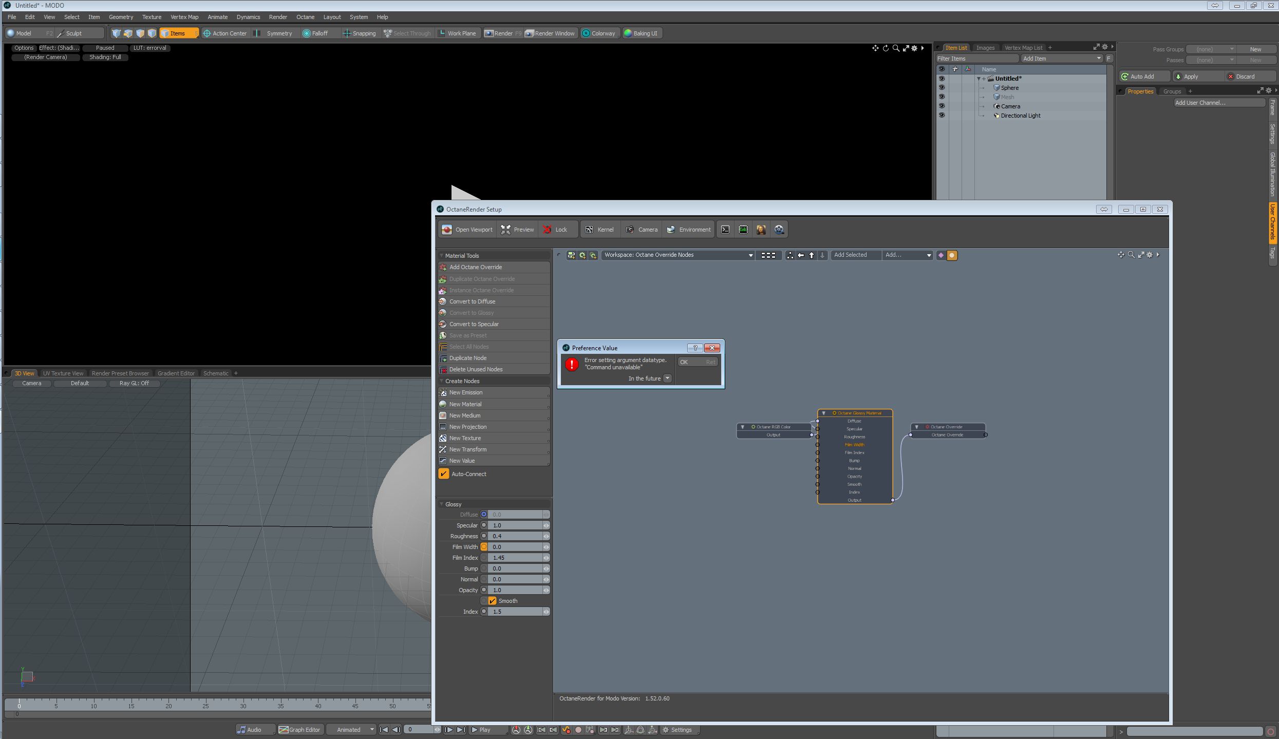

Hello, I've got an error.
Modo 902 SP1& 901 SP3 win7 x64 ent:
face_off
Posts: 15799
Location: Adelaide, Australia
Hi. Which version of the plugin are you using pls? Was it random, or are you able to reproduce it (in which case, can you tell me the exact steps needed to get the error)?
Paul
kostache
Posts: 63
Joined: Sun Mar 17, 2013 12:47 pm
OctaneRender for Modo901 2.24.2.89 (64 bit). It appears when I pressing on "OctaneRender viewport" button. It's strange, but "about" showing me version 1.50, March 2014
funk
Posts: 1207
Joined: Mon Feb 07, 2011 1:24 pm
Location: Australia
Go to C:\Users\USERNAME\AppData\Roaming\Luxology\Configs
Delete any octane directories then reinstall the plugin. You should only have 1 directory called "OctaneRenderForModo901"
Win10 Pro / Ryzen 5950X / 128GB / RTX 4090 / MODO
"I am the resurrection, and the life: he that believeth in me, though he were dead, yet shall he live" - Jesus Christ
kostache
Posts: 63
Thanks!! It works!
