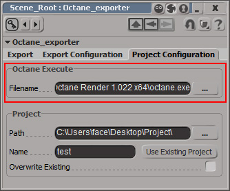

Installed Octane Render 1.022 beta2.2 (Recommended/Stable). I always get the error "Path to octane not found" on SI 2011.
Can anybody tell me which version of the plugin I should use to get it running? Maybe this was answered before but I am not following this thread on a regular basis.

Have you link the Octane.exe to the project?

- Attachments
- binary.jpg (41.69 KiB) Viewed 3951 times

I got it working now. I have not a clue why it is working now, but is does. After almost 2 hours installing and uninstalling etc. the different versions of octane and the plugin. Maybe some strange energy field is interfering with my computer. Is there a full moon tonight?
Thanks face for the plugin...

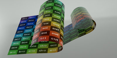

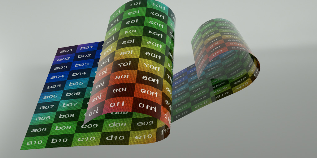

A scaled, roteted, translated and deformed SubD instance model with a texture
