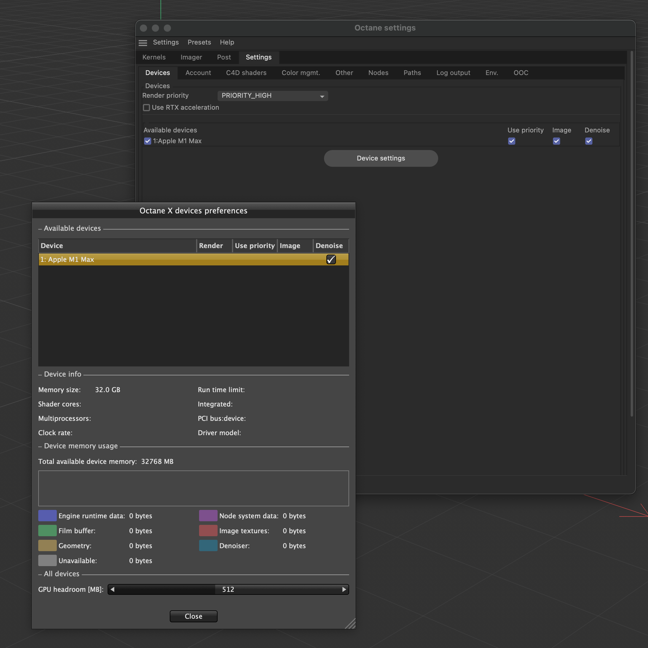

baugestalt
Posts: 48
Joined: Mon Apr 23, 2018 9:33 am
hi beppe
I still get the same error. the tick box for image always gets deselected in the settings. standalone works for me.
best regards
yves
Posts: 10564
Ok, I have updated the previous post with the public link.
About devices panel, weird, it should be like this:
Please close c4d, then delete the oct.dat file at the following path, the c4doctane preferences will be reset to default, and a new oct.dat file will be created on next c4d start:
/Users/USERNAME/Library/Preferences/Maxon/Maxon Cinema 4D R2X_RANDOM_CODE/prefs/oct.dat
Note that the Library folder is an hidden folder so you need to press OPTION/ALT on your keyboard, then from the Finder menu, choose Go/Library and locate the Maxon folder..
ciao,
Beppe
baugestalt
Posts: 48
that's strange. I just deleted the .dat file but my preferences still look the same. anything else I could try?
I'm on M1 and the latest macos beta (15.1).
Posts: 10564
Ah, ok, you need to wait for c4doctane 2024.1-Beta3 that should be released soon.
ciao,
Beppe
baugestalt
Posts: 48
aaah sorry, I misread the version number... thank you!
