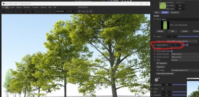

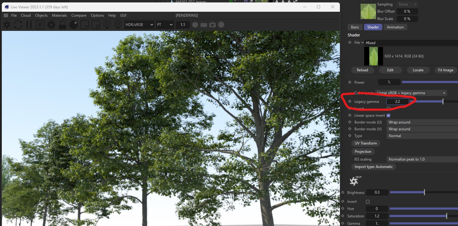

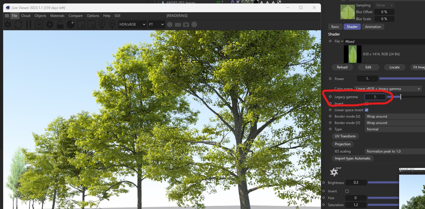

Please see what I mean :
Octane default 1.0 gamma for transmission :
Rest of the world - 2.2 default gamma for transmission :
Architectural Visualizations http://www.archviz-4d.studio
Posts: 16067
Location: Türkiye
SSmolak wrote:Please see what I mean :
Ok I will change it
