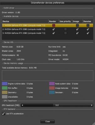

As I said earlier, I can't use all my GPUs with this build. Only two can be selected.

The third GPU cannot be selected:

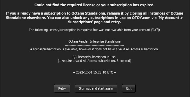

Enterprise version 2021 is not working at all, license is for Studio+ not Enterprise.
I've checked Standalone version 2021 and it has the same issue.

As wrote please contact to support. Studio+ is new type and this build done before the license update.J.C wrote:Studio+ version 2022 is working fine, all GPUs are available.
This is expected, all previous Standalone and plugins Studio versions cannot have more than 2x GPUs, and there is no Network rendering interface.J.C wrote:Studio+ version 2022 is working fine, all GPUs are available.

You need to run a previous Enterprise version to have Net render, and more than 2x GPUs support.
What type of license did you have before 2022.1 upgrade?
Can you share the error message you are having if you run Standalone or c4doctane Enterprise version?

Here is the error
							Previously I had Enterprise license. Here is the error message.bepeg4d wrote:

Ok, I have forwarded your report to the team.J.C wrote:Here is the errorPreviously I had Enterprise license. Here is the error message.bepeg4d wrote:
