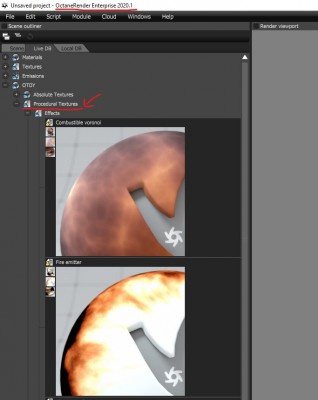

Here is a screen shot of the procedural textures in the Octane stand alone 2020.1
2020.1 Procedural Textures

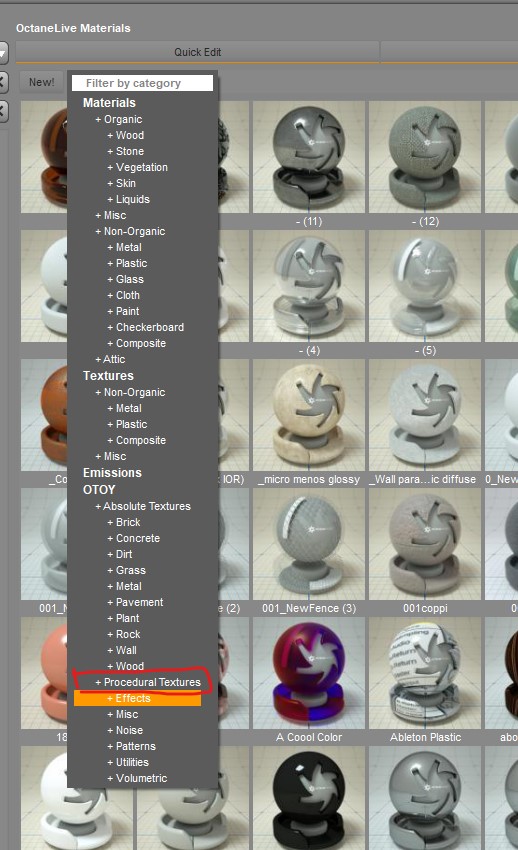

I can see them in the Daz Plugin.
Daz Plug 2020.1 Procedural Textures

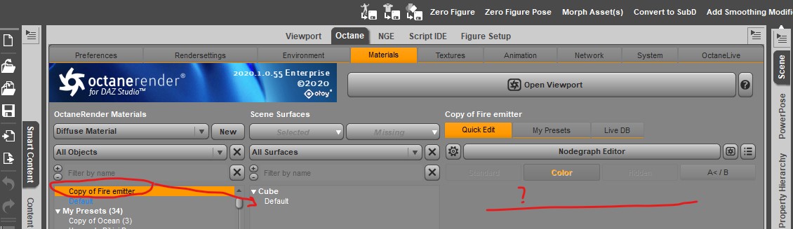

But they can't be used. E.g. I tried to drag and drop the Fire Emitter Texture from the Procedural section to the Cube->Default. It allowed me to drop (and create the copy of Fire Emitter automatically) but it won't set. Clicking the Cube Default shows nothing set.
Fire Emitter Procedural Texture can't be used.
Some with patterns do allow you to drop but don't show the patterns in the rendeer. And under the NGE they look like not supported nodes.
They are Octane Textures, not Octane Materials, so cannot be loaded as a material into the DAStudio plugin.

So when can be have support for Octane Textures in the Daz Octane Plugin ?
I think it would be pretty complex to implement, as it would need to be done in the NGE, and there is currently no facility there to import textures. The textures in the LiveDb can have sub-graphs, etc, so the actual conversion of LiveDb textures to the NGE would require quite some effort. I think there are many other higher priority features/bugs that need to the implemented/fixed, so would suggest holding on to this one for the moment.
