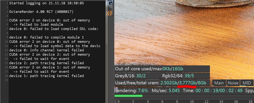

I have a render failure problem with out of memory. Weird thing is that it happens while Octane live viewer shows that there is still plenty of VRAM available. (see screenshot).
In addition, the out of core option is enabled in Octane settings (16GB, 512mb).
System is Win 7, C4D R16, 32GB Ram, 3x GTX 1080. The scene is interior architectural scene with quite a lot of objects, but for this test I turned visibility off for most of the stuff, also vegetation turned off (multicloner, tree instances, etc)
Is this a common issue? Why does it show I still have 3.7GB free VRAM when it crashes?
Any optimization tips?
Thank you!
EDIT: I followed GIOLETS' suggestion here: viewtopic.php?f=30&t=69304, changing the TDR parameters and the problem went away. Thanks GIOLETS!

Hatsize7 wrote:Hi there!
Thank you!
Possibly! Please disable monitoring gpu for render and try again.

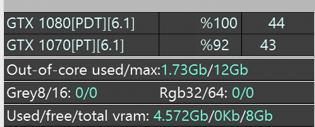

Octane cant handle 32m triangles. Will be stable verision handle this amount of polygons?
Posts: 16068
Location: Türkiye
Cheiser wrote:Octane cant handle 32m triangles. Will be stable verision handle this amount of polygons?
It can handle as you have VRAM+RAM. I have gone more than 60m polygons.
Cheiser
Posts: 62
Joined: Wed May 11, 2016 1:27 am
I have 1070+1080 (both 8gb vram).
And 40gb RAM
Octane crashed
Cant share my scene
I just testing octane polycount capability
Posts: 10643
it seems that you have only ~4.5GB of VRAM available, so at least you can load less than ~20M polys, try to use Out-of-core geometry, if you have enough RAM.
