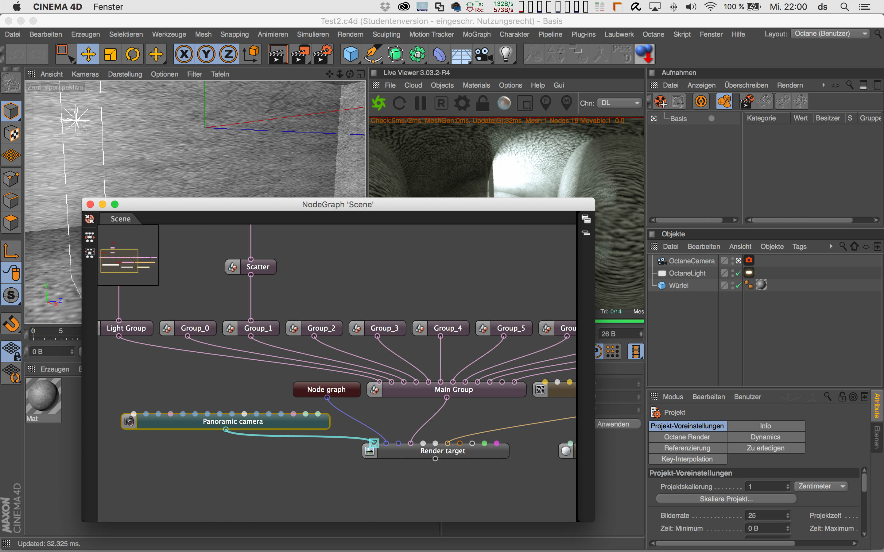

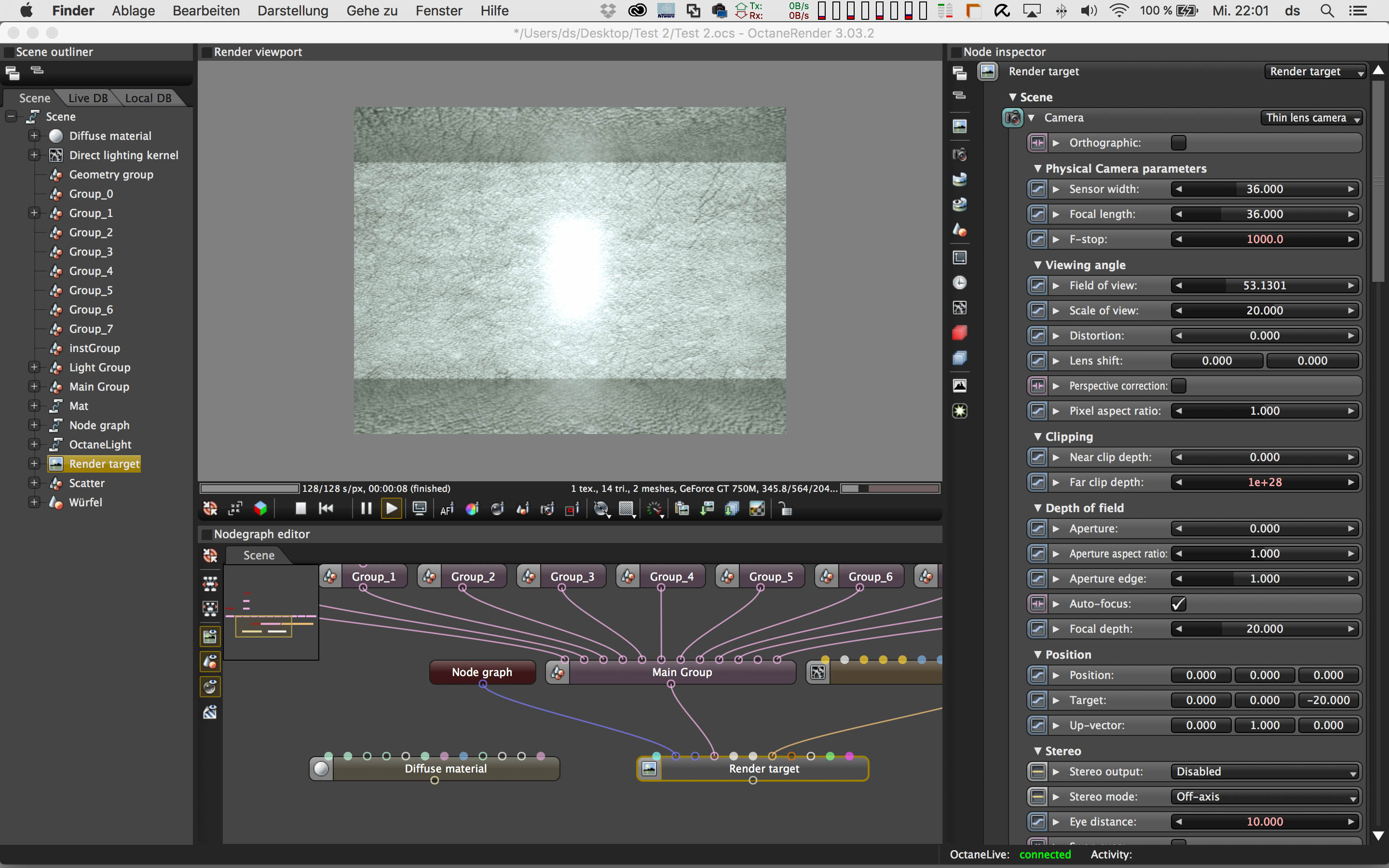

If I export a scene to an .ocs or .orbx, the camera node is gone (see screenshots). Do I something wrong?
I am on OS X, R17, Standalone 3.03.2b and Plugin 0.03.2-R4.

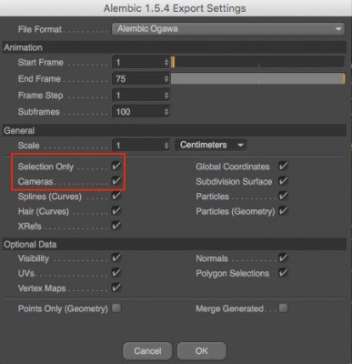

Hi David_S,
you can select multiple camera in c4d and export them in alembic separately from c4d export menu with this settings:

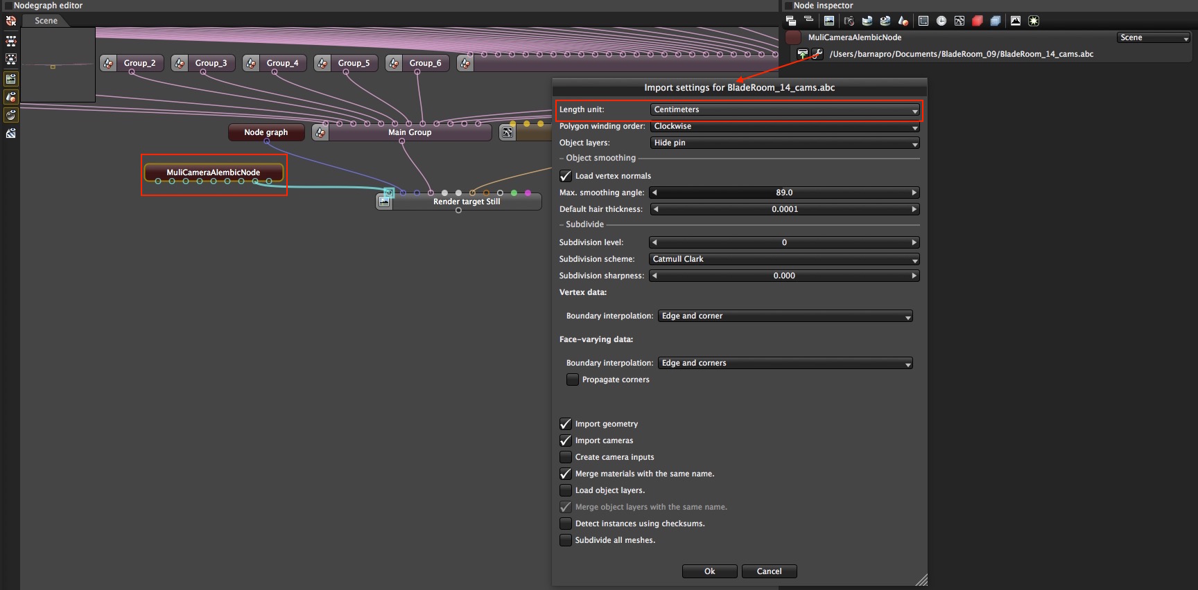

then, you have to change the scale from meters to centimeters within Standalone by clicking on the Edit setting button of the imported alembic node:
ciao beppe

Ciao Beppe, that seems to work. Thanks.
So it is currently the only way to export Cinemas camera position and settings?
Posts: 16068
Location: Türkiye
David_S wrote:Ciao Beppe, that seems to work. Thanks.
No. That's an old command and it's ignored for some time. You can use animated orbx export OR wait for next build. I may try to fix.
