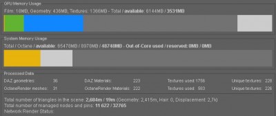

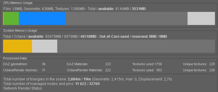

I continue my bug list (don't know if it's a bug, but very annoying).
I have a scene I would like to turn around (animation).
Initial scene take a certain amount of memory :
So this scene could be render with my 780Ti (3GB)
After making the animation and go to a random frame, I get this :
And I can't use my 780Ti anymore !?
Is there some duplicate figures out there to increase so much the geometry ?
OctaneRender material / Textures used and unique textures data seems to decrease, but GPU Memory hase increase alot.
Something wrong ?
I will try to do another scene...
It looks like the geometry is taking more space, but there are not more triangles in the scene. I couldn't reproduce this issue on a scene with the SubDragon figure. Perhaps it is something specific related to you scene that is triggering this.

Hi Paul,
Yes, I think that's something wrong with the scene. Perhaps, when I use group, but not sure.
Test also with Daz 4.8 + OcDs 3, Daz 4.9 + OcDs 2.24 and Daz 4.9 + OcDs 3 : same issue.
It's about the animation. When I use fisrt frame and turn camera, it's OK.
Could you point me a direction to investigate ?
What a pity that I have not saved the scene before making the animation.
I will try to reset the animation. What is the best way to clear all animation ? (save subset scene ?)
thanks
thanks
I'm sorry - I don't have a clear understanding of the exact workflow you are following. I suggest trying to reproduce the issue with a simple scene (with just a blank G3 figure). If you can get the problem to occur that way, send me the scene, and give my the exact steps you are taking to get the problem, and I will fix it.

So I think that i could reproduce it :
1) load a V7
2) render to get about 20 MB on geometry (system tab) and about 700MB texture
3) go to texture and resize 1/2 some textures.
4) go back to system : OH no, geometry size increased :?: , but textures decreased :P
5) in timeline, go to next frame (some hang)
if you can't see geometry size increase in step 4, just hit render and it will refresh the status.
Go back in texture size to 1, reset geometry size.
Note that I already state that resize texture is "permanent on this figure" on all your loaded scene until you resized it to 1.
Hope you understand what my pb when I have too many texture and can't go with OOC feature as render time is reduced cause of my PCIe USB extender.
Hope you could fix this.
Thanks Paul.
