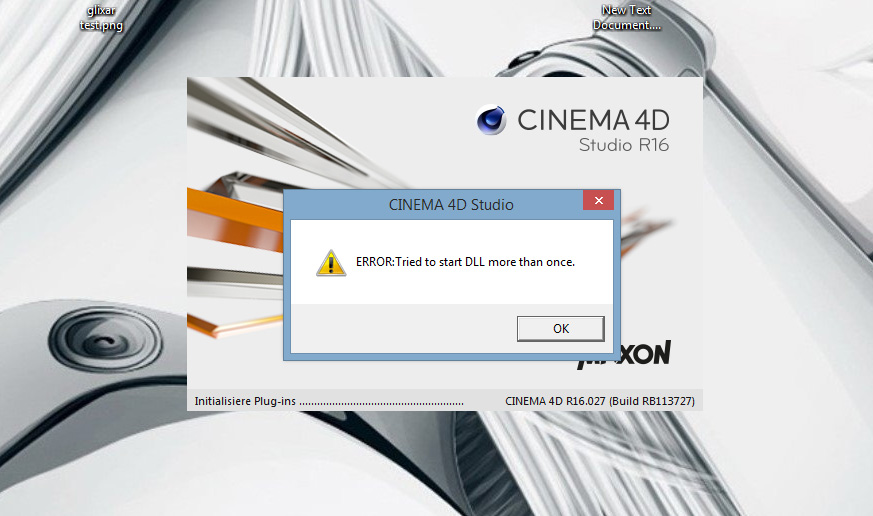

						Since i installed the 2.21.1 version i´ve always get this errror massage at start! (3 times in a row)
Standalone version is 2.17!
I also tryed to reinstall both the standalon incl. the plugin but it doesn´t changed a thing!
Also if i try in cinema 4D to open the live material libary from octan it crahses.... =/

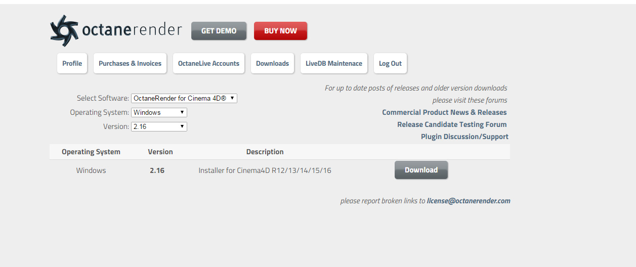

Why is in my downloadsection the cinema plugin just max. 2.16?!
Read here: http://render.otoy.com/forum/viewtopic.php?f=87&t=45194nbeyond wrote:Since i installed the 2.21.1 version i´ve always get this errror massage at start! (3 times in a row)
1. On encountering DLL errors at startup, be sure to delete the other .cdl64 files (R14, 15 etc.) in the plugin folder.
It's 2.16 in download section because that's the last stable version. They don't list the new one cause it's not ready for production (development build). Lots of glitches and stuff going wrong because they added new features. If you're going to try the latest version, you need to download the plugin AND standalone 2.21:nbeyond wrote:Why is in my downloadsection the cinema plugin just max. 2.16?!
C4D Plugin Windows
http://render.otoy.com/customerdownload ... .1-win.zip
C4D Plugin Mac OS X
http://render.otoy.com/customerdownload ... Macosx.zip
Standalone Windows
http://render.otoy.com/rcdownloads/Octa ... _win64.exe
http://render.otoy.com/rcdownloads/Octa ... _win64.zip
Standalone Mac OS X
http://render.otoy.com/rcdownloads/Octa ... _macos.dmg
