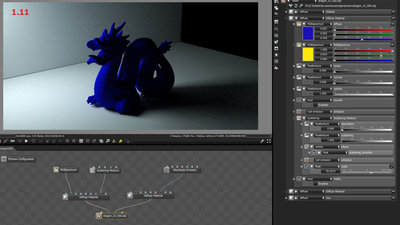

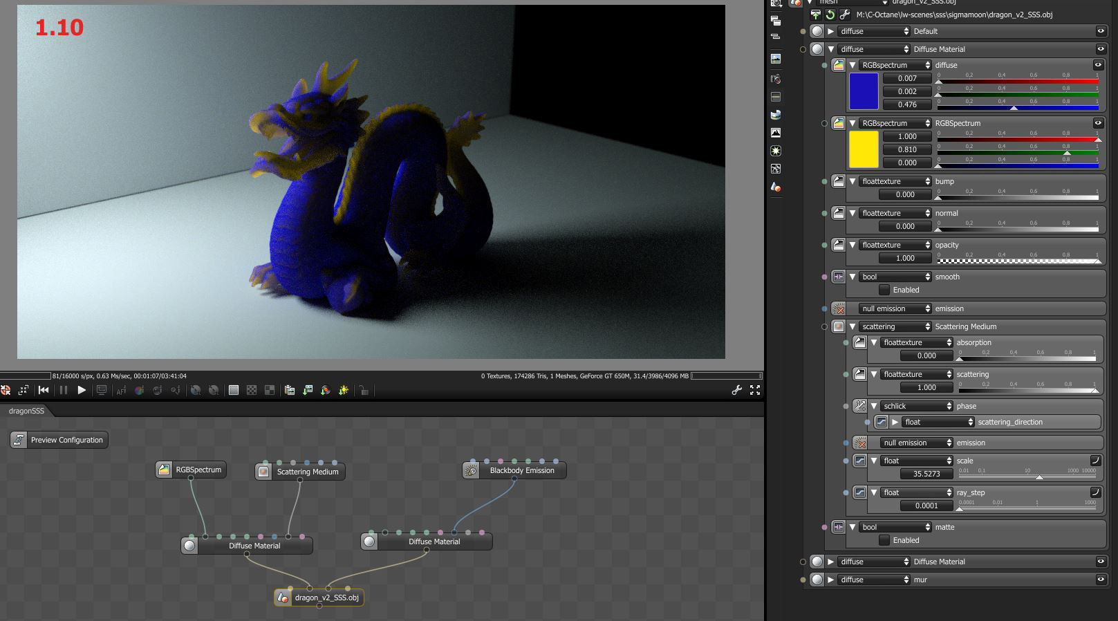

Some users report problems with Lightwave plugin and Scattering node. The behavior of 1.10 libs and 1.11 libs are not the same, or doesn't work at all.
I have a very simple scene that show the problem. This scene in Standalone 1.10 works fine, in 1.11 doesn't work like 1.10.
Anybody else has this kind of issues with scattering node and 1.11 release?

juanjgon wrote:Some users report problems with Lightwave plugin and Scattering node. The behavior of 1.10 libs and 1.11 libs are not the same, or doesn't work at all.
-Juanjo
you can see a video to explain this simple sss ocatane scene v1.10 (juanjo give you the SSS.rar file to try it)
[vimeo]http://www.vimeo.com/62791331[/vimeo]
could you tell us if the standalone v1.11 have some trouble with the SSS node or how to reproduce this effect inside the V1.11?
thanks to help us to understand this trouble thing.
