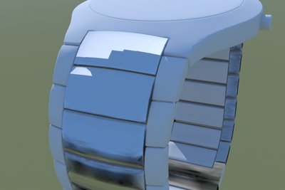

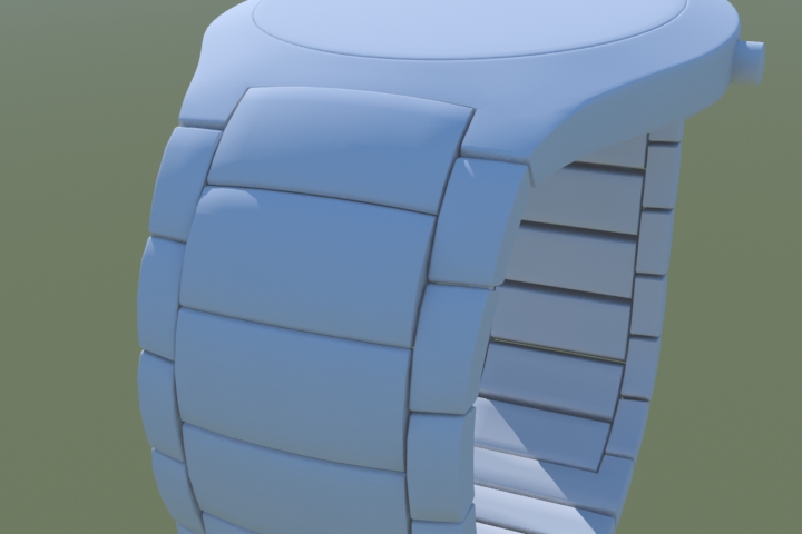

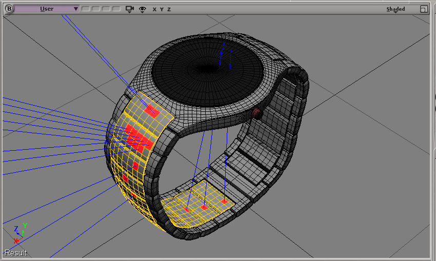

The surface normals shown not ok on the exported obj...
Hm, when i export that with the softimage obj-export, it shows the same :?
When i import the mesh in Modo, it shows as in the images...
And, he has no UV´s :?
But now i must go to work...

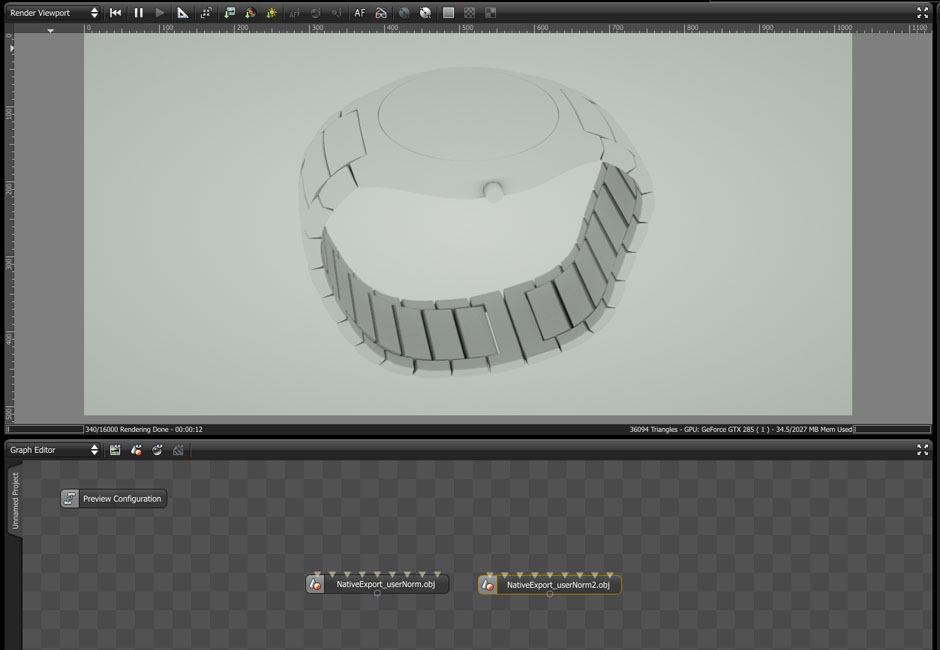

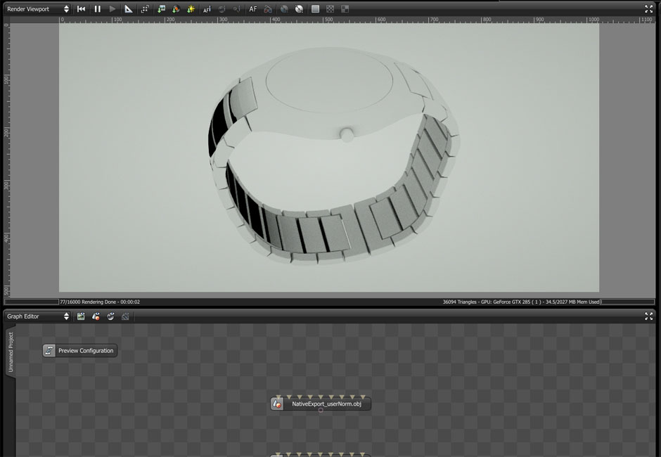

face
With normals
With normals
Without normals

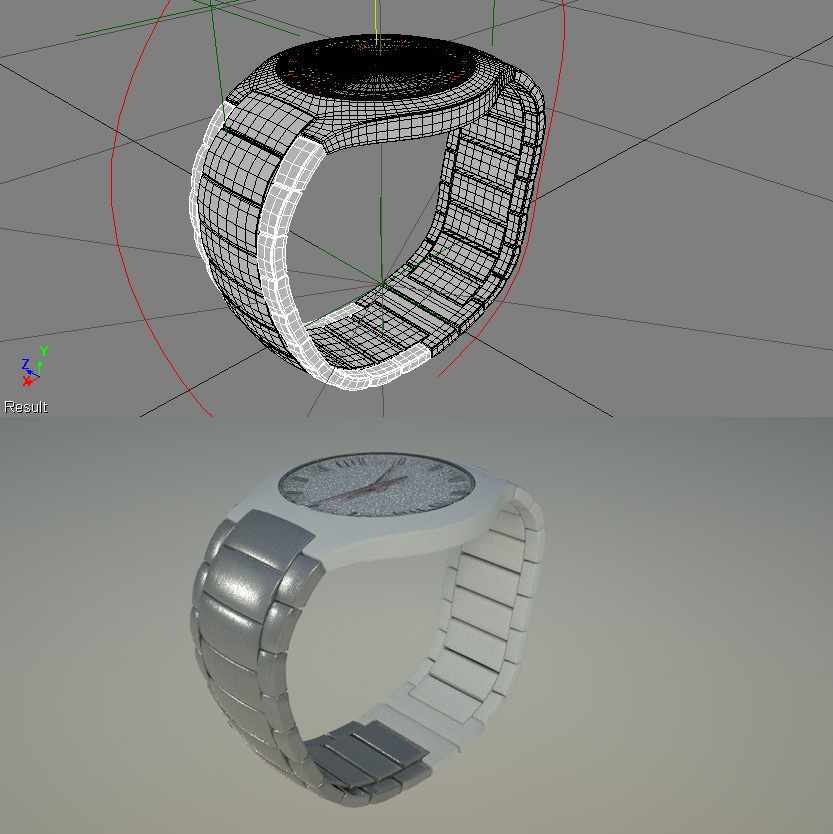

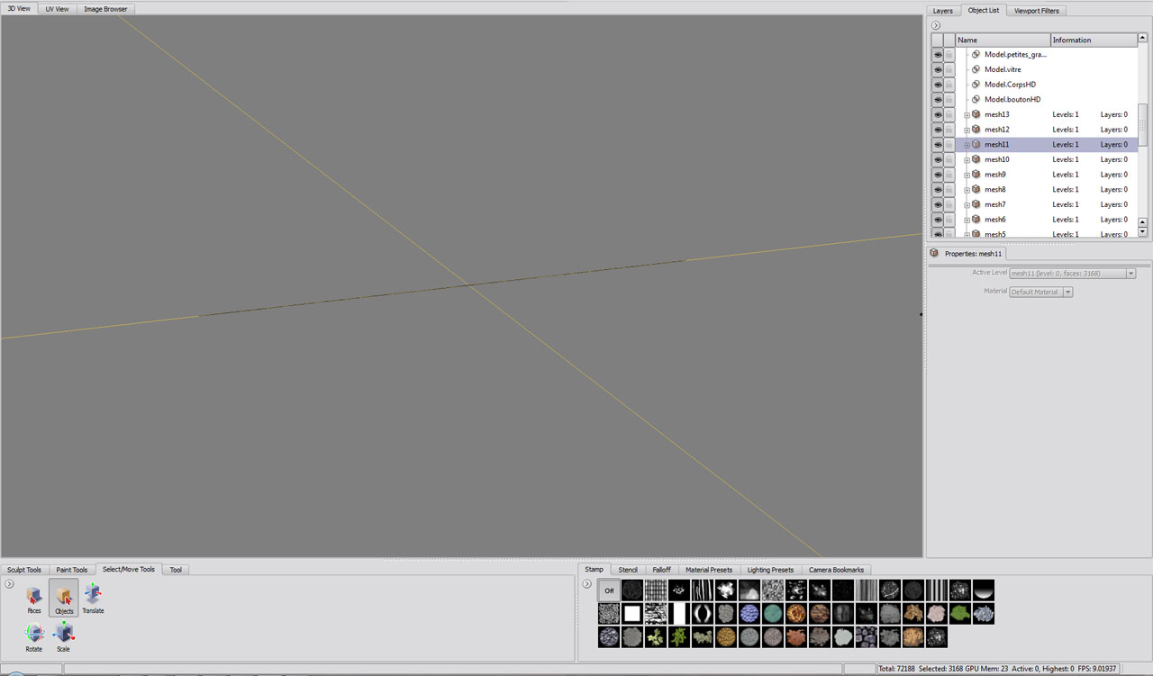

:shock: all right, done more testing with the .obj on my side:
- if I reimport an .obj made with the native xsi exporter i get this:
it looks correct, the normals are unaltered. It is correctly read by Mudbox too.
- if I reimport an .obj made with the new exporter however all I get is a flat line :? (same in Mudbox so it's not XSI)
so there is definitely something strange about the .obj normals output.

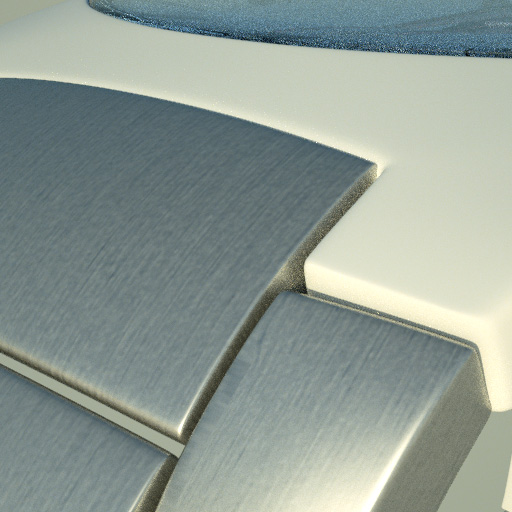

but be it with your plugin exported .obj or native .obj (manually loaded in octane) ... in Octane with both I get the same shading/smoothing error. :|
however if I manually import the .obj into octane (both native or plugin) and unckeck the option "use OBJ normals if supplied" , it renders fine without errors.
thanks for your help anyway.

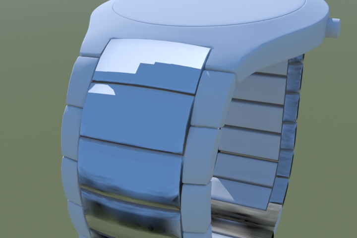

face
Posts: 3204
Location: Germany

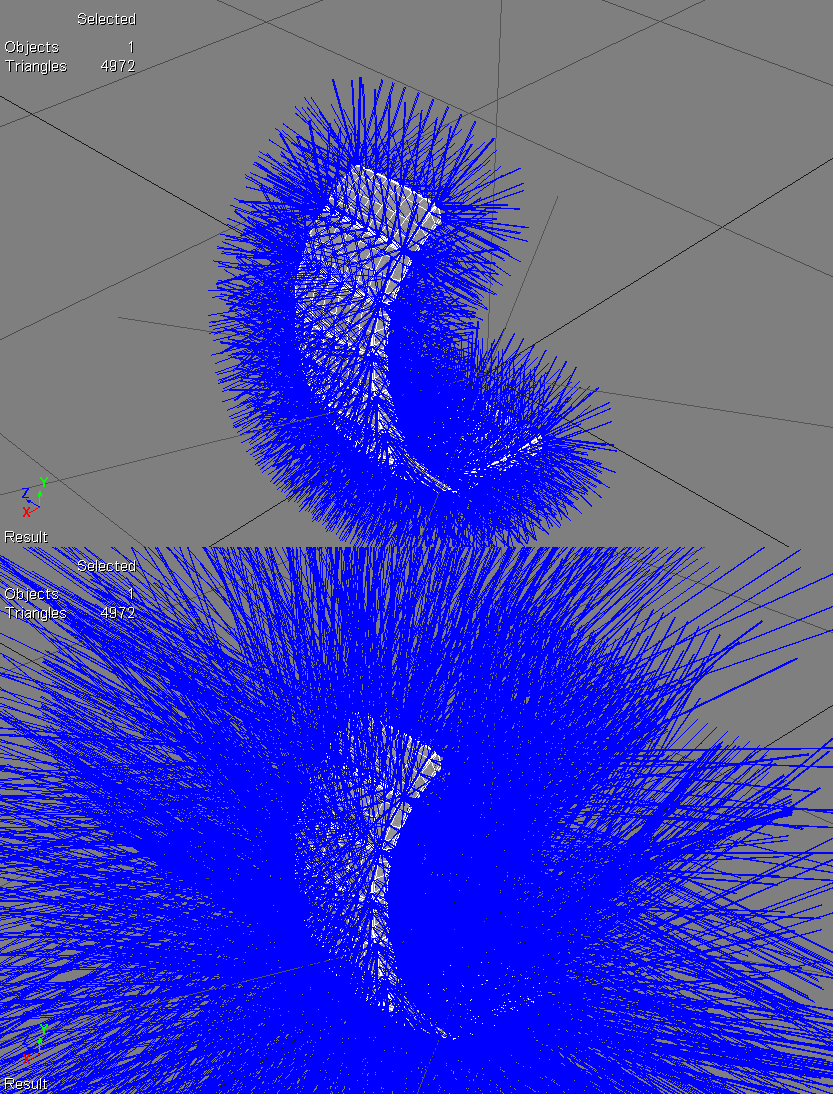

When i use the original obj-export with the option "User Normals" and reload it in Softimage, but see the image...
face
Top is original, bottom with export the user normals.

I found the solution!
This was my fault. The error in the normals export was caused by a rotation (-180°) applied to the left part of the wristband. I zeroed the rotation by freezing the transforms before export and now the normals are OK in Octane.
pfiuu, I can have a drink on that one! :roll:
ps: that's my watch mlody47

Yes, i have seen that too and i found a solution without freezing ;)

Seems to work correct ;)
Some rotation, some +/- scaling.

SubD´s also working with +/- scales and rotations :)
