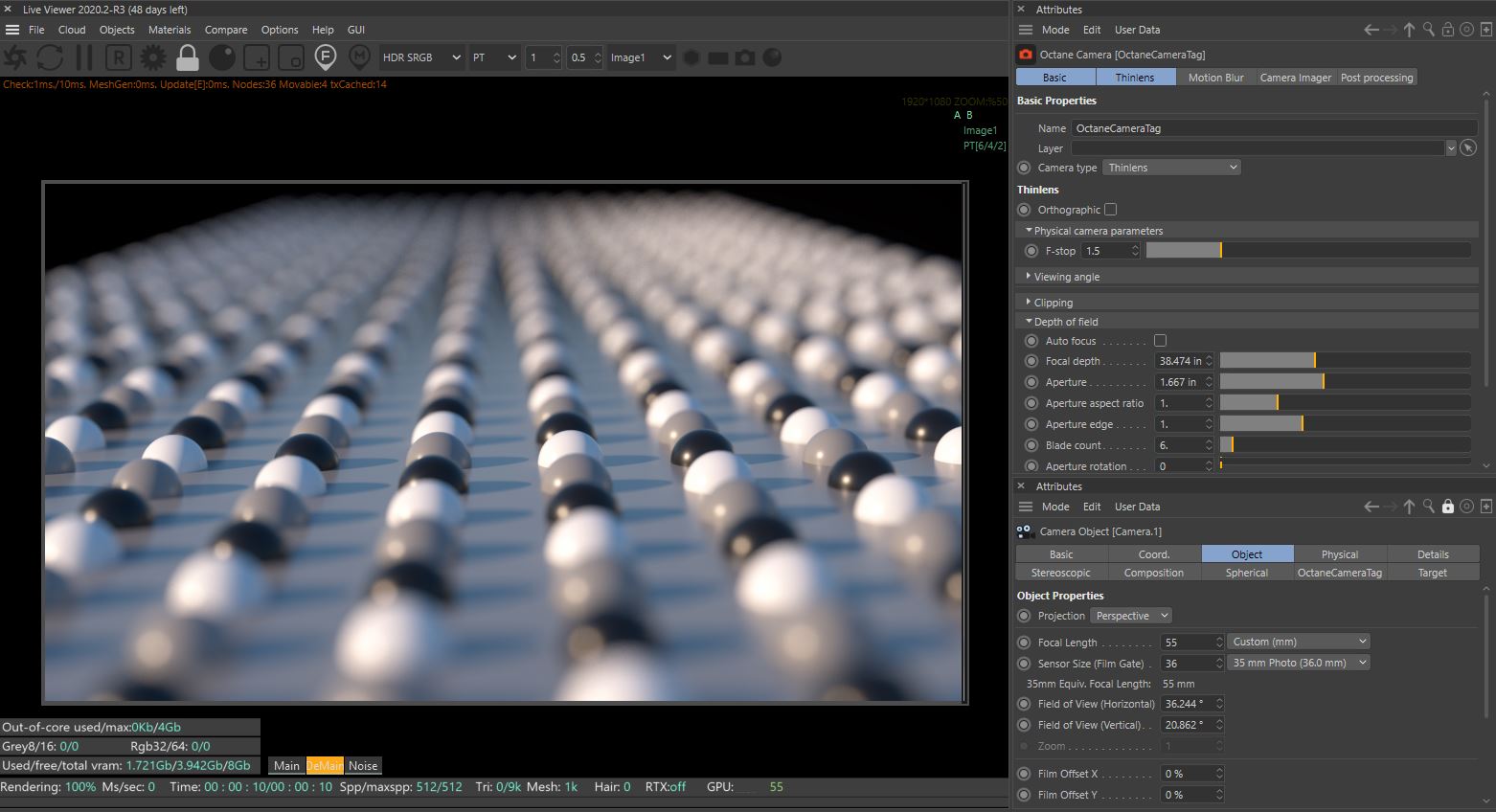

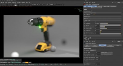

Unless I am misunderstanding your setup, I don't seem to have issues with dof... Do these look accurate to you? In this example, the White, Gray, and Black Spheres (1.5in Diameter) are each 10in apart.
If this looks correct to you - Here is a sample scene with a bunch of spheres.
https://drive.google.com/file/d/1PZq4FY ... sp=sharing

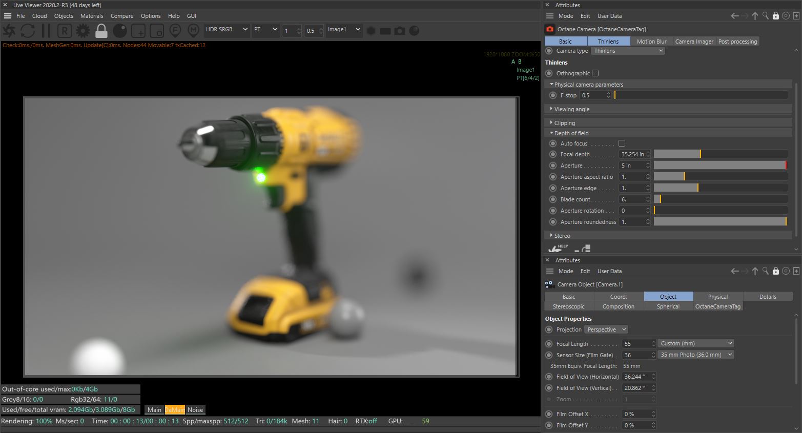

Your setup is ok, but we are talking about something else.
What the image will look like in real life when the aperture is 0.5.
With 0.95 aperture objects already totally blurred like this. And if you set you camera to 0,5 f-stop you get super blurred image with one or two petal of flower in focus.
Therefore, what is designated in octane as an а-stop 0.5 is not correct and has nothing to do with real optics.

Actually You guys are right, I tested different way now, changing scene size. It actually works how it should. Also I updated to R23 and Octane is working way smoother on R23 than R20.
