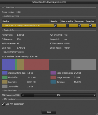

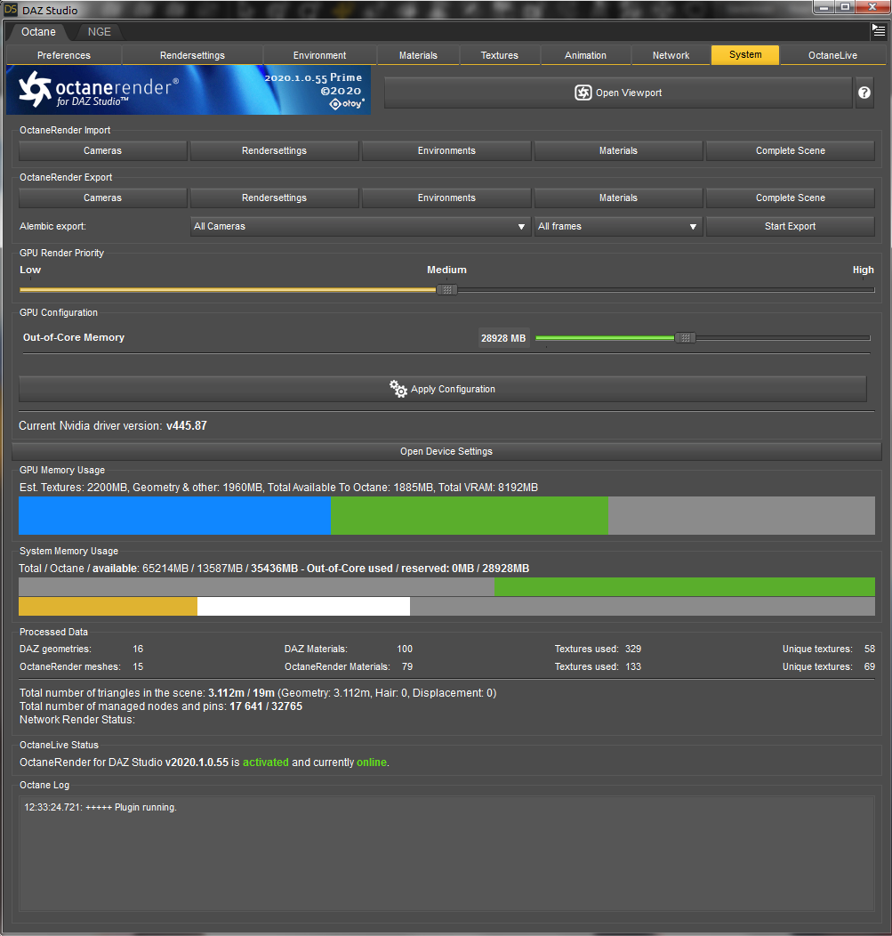

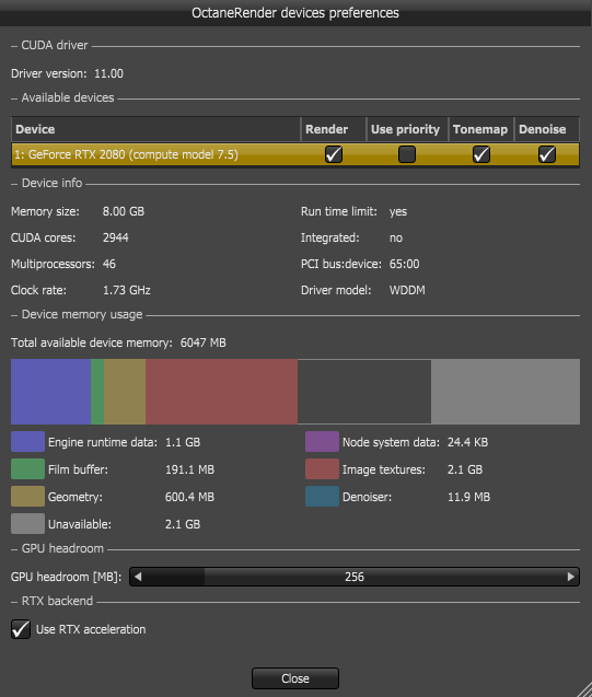

face_off wrote:
At the time I was using Texture Shaded view with cameras switched in between with Perspective.
OK, thanks. For testing, may I suggest recording your OutOfCore settings, and also have Windows Task Manager open to monitor your memory. It would be good to see if the crash occurs when you have a lot of free VRAM and system RAM available, and if it only happens if OutOfCore is enabled or disabled.
Paul
OoC settings I have set at 28928MB out of 64GB I have. Kind of overkill, but I'm curious about the scenes that exceed measly 8GB VRAM Nvidia puts in, well, high end cards after all. But that scene wasn't exceeding the VRAM capacity, it was about 75% full at the time. Example on the config/status screenshots has a bit lighter mesh, but still quite a bit of data. DAZ updated the beta to 4.12.1.117 in the meantime, and these screens come from it.

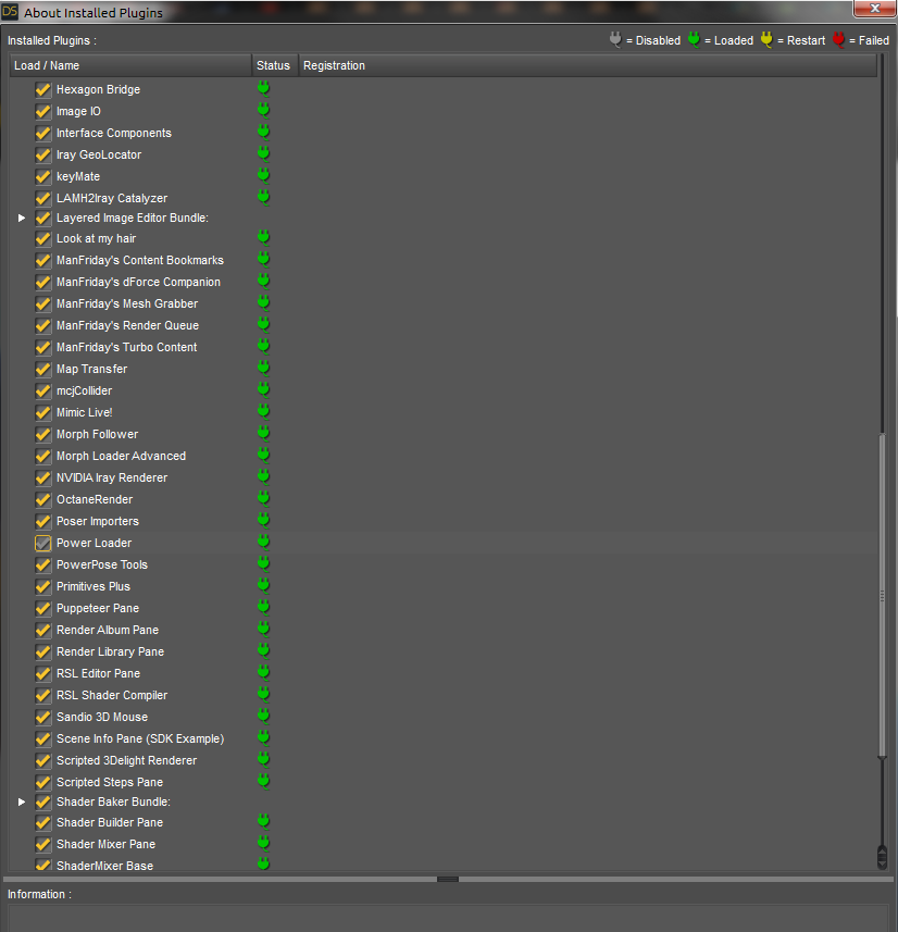

AVX-512 issue with Iray still isn't fixed. :P
I'll attach the screenshot of most custom plugins I have as well.
I suggest reducing this, or turning it off, to see if it resolves your crashes.
