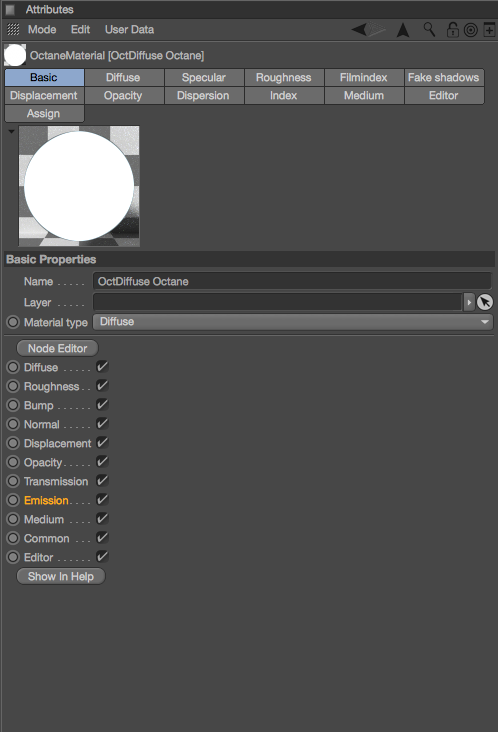

I just installed the R2 update and it seems like the "Emission" tab has disappeared from the material?
(In the attributes manager, it's still there in the node editor)
Am I the only one with this problem?

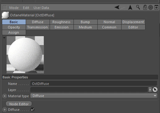

Posts: 110
Joined: Sat Apr 11, 2015 2:58 pm
Still there. R16 though.

mr_seq wrote:I just installed the R2 update and it seems like the "Emission" tab has disappeared from the material?
Confusing. You're on diffuse type and tabs belong to specular type.
