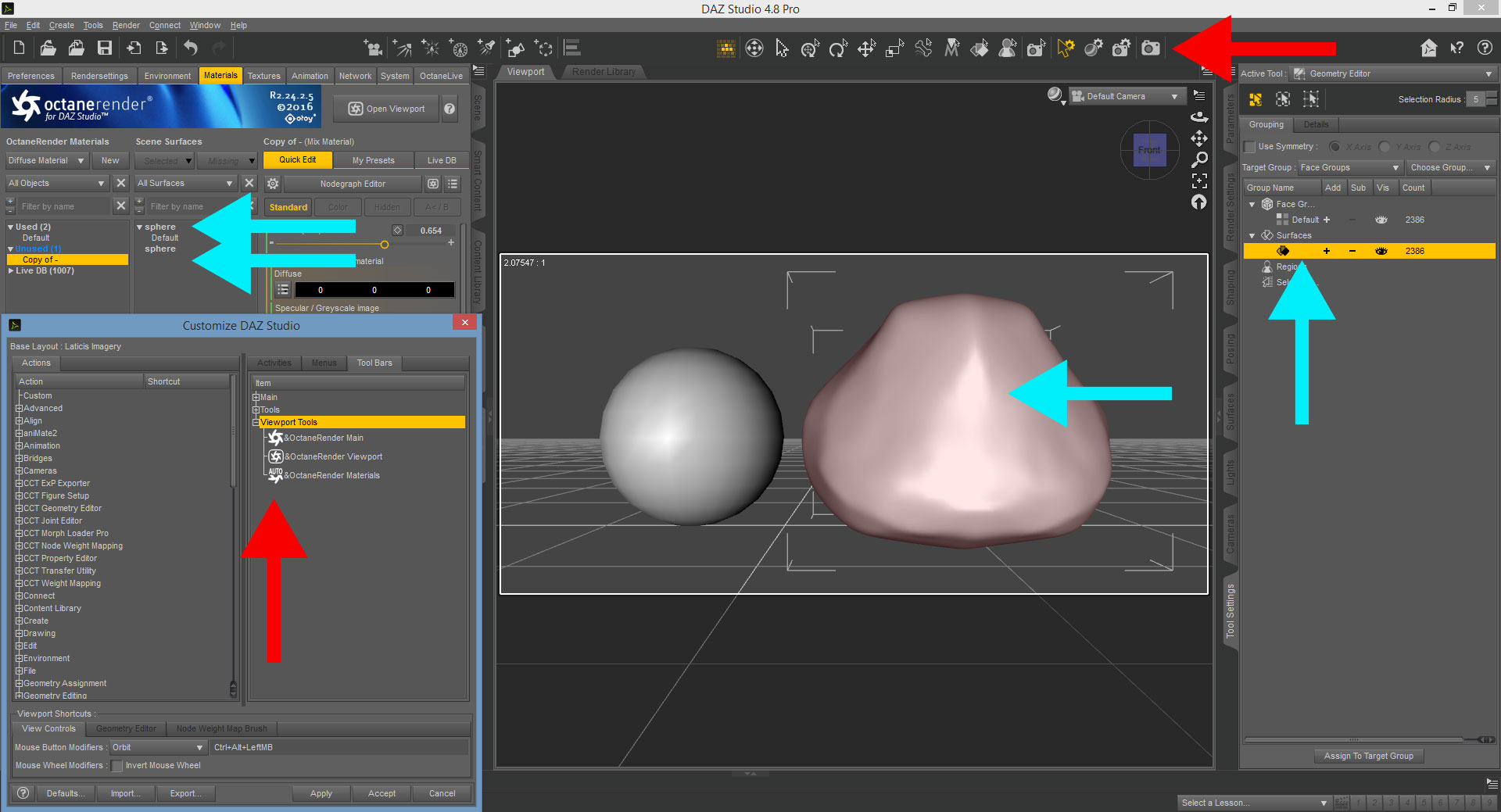

My PC has been down a for over a month but I am finally back up and running with a clean slate and a new motherboard.
It is really great to see further development happening towards the DS plugin.
Based on a fresh installation of applications and OS with the focus on DAZ Studio 4.8.059 and OctaneRender_2_24_2_win64 with OctaneRender_for_DazStudio_2_24_2_5_Win64
I have one issue with the interface I have been able to resolve - the Icons for the Octane Main / Viewport / Materials is missing from from the DS Interface that normally reside beside the Camera Icon
They are showing up in the custom tool panel though. Red Arrows to represent issue.
The secondary issue has been a long standing one that t_3 was looking into but hasn't been resolved. It used to work in the past but a few builds ago it broke.
DAZ / Octane / ZBrush and GoZ ( this could be more of a DAZ GoZ thing, not sure )
Example:
Sphere added to scene and has a 'Default' Surface Name / Hit GoZ to send Object to ZBrush - sculpt - remesh and GoZ back / The new object comes in with a surface but no name but Octane's Material Tab
with register the object but will not accept any material application until I rename the surface in the Geometry editor.
Granted an easy fix but the process becomes tiring especially when testing Fibermesh :)
Light Blue represent issue.
Cheers Adriano
