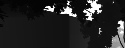

Hey Aoktar.
Im using Rednerpasses and I am wondering if I am doing a mistake with my Z-depth-pass. If you look at the image below you see, that the leaves of the trees don't show the alpha. The depth shows the pure geometry. Is this an expected behaviour or am i missing something?
