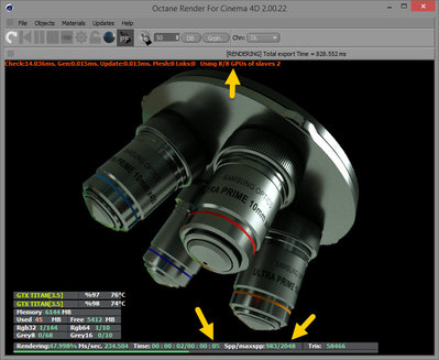

How to Network Rendering ?
(Limited 12 GPU - Including Master Station)
0. Master (C4D, Not Standalone. No Need Standalone)
Check YOUR IP Address (This is Octane Master IP)
1. Slave
Install octane standalone
2. Slave
Run Command Prompt(Run As Administrator)
Change Dir c:\program files\OTOY\OctaneRender 2.00\
Run Command
octane_slave --net-master-port 21000 --net-master-address Your_IP
(ex : octane_slave --net-master-port 21000 --net-master-address 192.168.0.24)
Auto Change Daemon Scan Range 192.168.0.1 ~ 192.168.0.254
3. Master
Run C4D. Open Live Viewer. Check Menu > Updates > Network Rendering
ReRun C4D. That's IT...
Thanks...Aoktar(Ahmet), Fooze

234 Mb/sec. Great! thanks eyeonestudio
