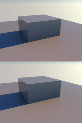

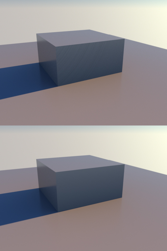

There is a bug with the daylight environment, also the same for the checks texture.
When the daylight is set to xyz( 0.0, 0.3, 1.0 ) you get circles on glossy textures.
In the first image you have the error. The second shows a x value of 0.01
The same is with the checks texture, when you have a plane with no thickness.

Isn't that a rey epsilon issue ? Just raise this value ina render kernel a bit and the circles should be gone.

BorisGoreta wrote:Isn't that a rey epsilon issue ? Just raise this value ina render kernel a bit and the circles should be gone.
Not realy, a change of the rayepsilon has no effect on this...

face wrote: The same is with the checks texture, when you have a plane with no thickness.
face
+1
A plane with no thickness displays checks like this:
A plane with 1cm thickness displays the checks texture correctly

The artifacts on the cuboid are a problem in the glossy brdf calculation if a light source lies exactly in the same plane as the side of the cuboid. We will fix this problem in a future release.
The artifacts on the checkerboard plane show up because the checkerboard is a volumetric texture and the plane lies exactly on a transition from black to white. Move the plane up or down by a small distance and you don't have these artifacts.
